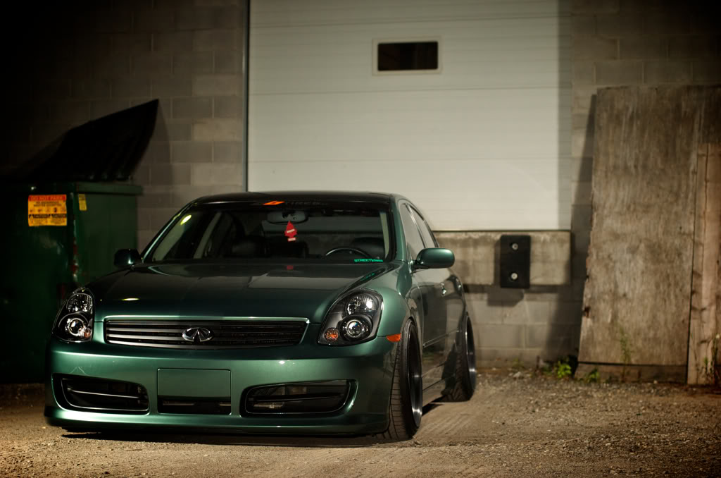

19x11.5 +16
19x11 +5

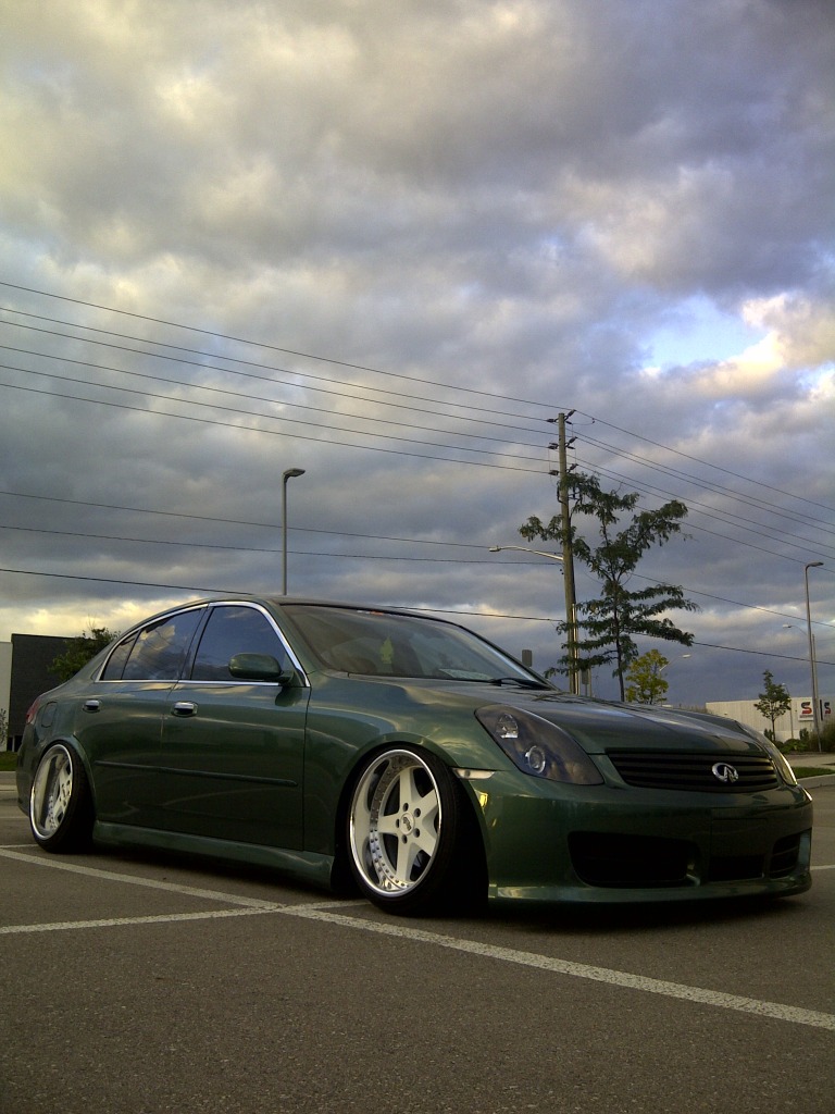

19x11 +20

OP, you're for a bit of work.
First things you'll need.
1. Trusted tire shop
2. Sick alignment shop
3. Fender roller or a local fender work beast
4. Camber arms, probably best to get them for both front and rear just so the adjustments can be made easy.
To fit 19x11 +15 in the rear you're going to need roughly -6 degrees of camber and a decent pull. Obviously if you add more camber you can pull less and vice versa. You'll want to run a 255/35 or 245/35. 245 is probably your best bet and can save you about a degree of camber.
The front is a little trickier, you'll probably end up with your camber about -3.5 or -4. Definitely want a 245 up here to help clear the fenders and then you will need to trim your front bumper tabs a fair bit to clear the 245 front tire, You're most likely going to go through side markers once a month, so stock up or learn to live without em lol The rest can be made to fit with fender work, the front fenders are very thin and maleable so they are easy to pull and flare.
However, if this is your first attack at aggressive fitment maybe back it off a little. Try a 19x10 19x11 stagger or even a 9.5/10.5 stagger just to get a feel for stretched tires and start learning your offsets.

4DGS---
I m looking at the 3rd pic above, the 19x11+20 , is that all the way around or just rear? Do u know what camber is set at & what tire sizes are being used?
