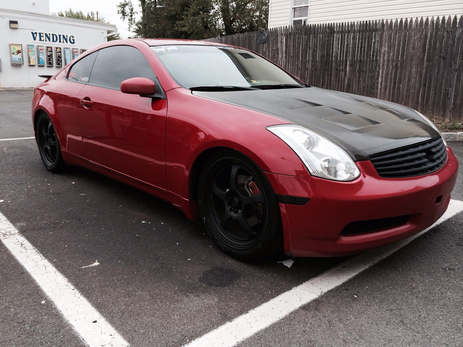

I have a 06 coupe with stock 17" wheels, TEIN S TECHS, and I just recently upgraded to 19" wheels. Now I am having rubbing issues on the splash guard and I have about 1/8" between my tire and the A camber arms. Sometimes also rubbing while turning. What's my options for a solution on this?

From what you posted you have wheels with the wrong offset and you're going to need wheel spacers! Don't make any quick turns at speed until you get this issue corrected! You can buy wheels spacers on our Marketplace, they'll sell you what works best...Gary

I got the motegi trak light

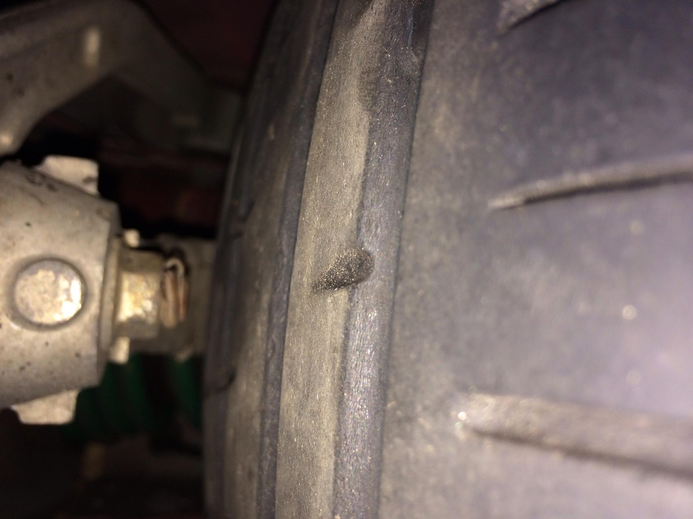

He is another pic I could barely get my phone up there

In response to the 2nd pic, I know that looks really tight and scary, but don't worry. As the wheel travels up and down with the suspension, so does the A arm. The distance between the A arm bolt and the tire doesn't change. You're either hitting it all the time, or you're not ever going to.
What are the offsets and widths on the wheels? And what size tires are you running?

Just took a closer look at that first pic. I would tend to agree with Gary above after seeing them. Those are pretty well sunken in, spacers might definitely help. But knowing the specs will help confirm that.
