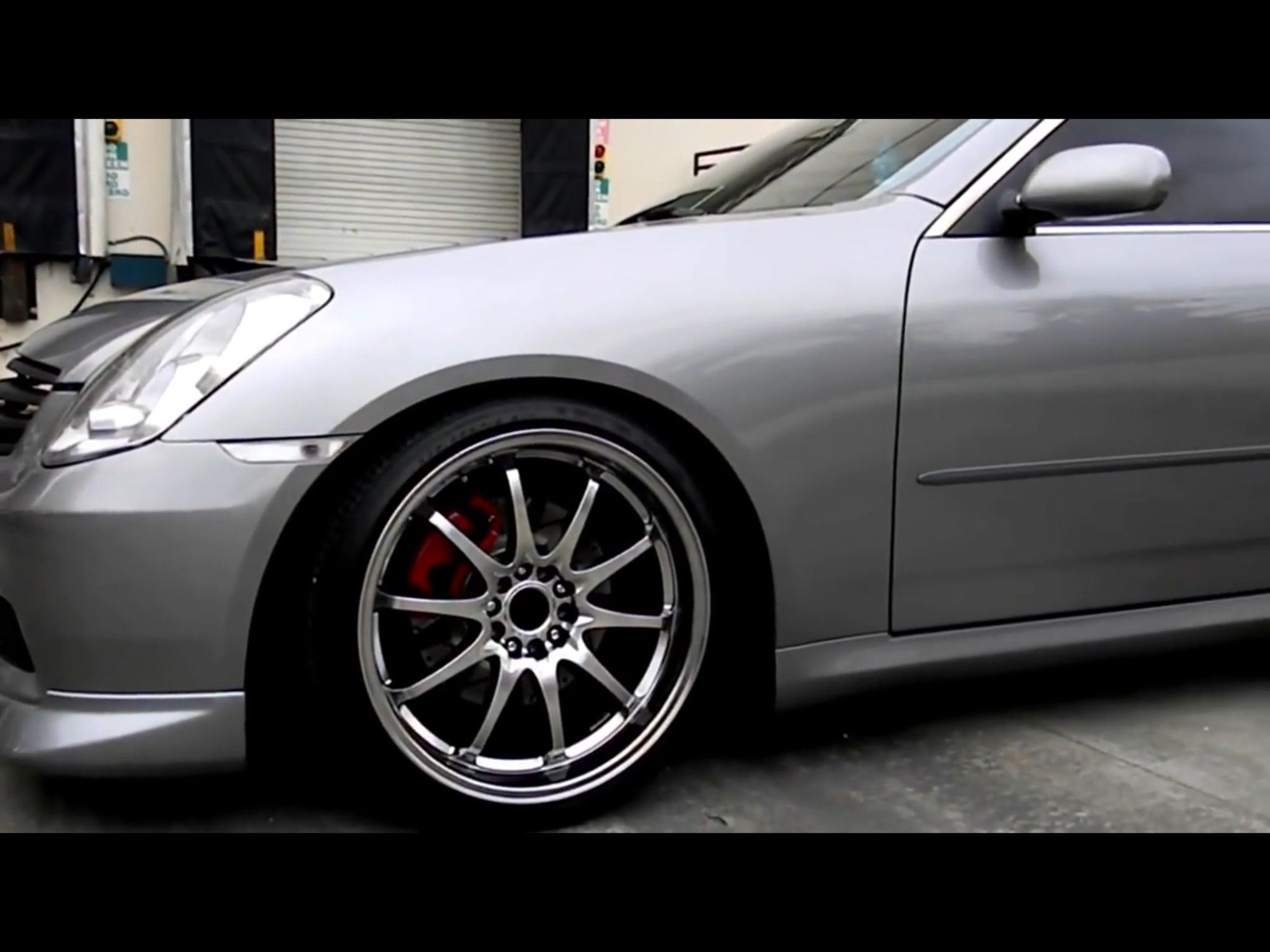

Hey guys, im looking into getting a set of 19x9.5 +22 wheels for my 05 sedan.
Im currently on eibach sportlines springs
Would these fit my car? Also what size tire would i need to run to not rub while still looking good/ flush?
Any help would be greatly appreciated guys, thanks

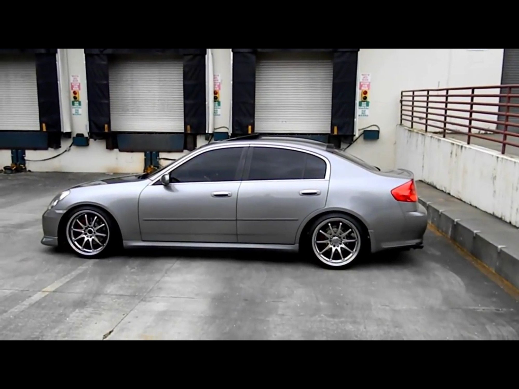

This is the look im trying to go for

275/35 245/35 would be good

I have 19x9.5 +29 with 245/35 on my fronts and they fit fine on my Coupe. They don't look stretched or anything. If you are looking for more of a stretched look, my friend runs 225 on his 9.5 and they have more of the look in the picture above.

There's something very wrong about putting 225s in a 9.5" rim unless what you own is a garage queen! If you drive your G a better is the 245/35, I don't like 225s on an 8" rim for any kind of freeway high speed driving...Gary
