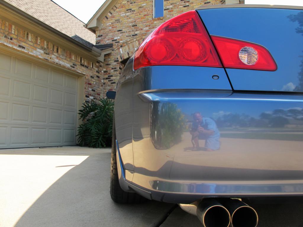

^^^You really need to do more research on your project before you go any further. You'll never get a 265/275 tire on a 10.5" wheel to fit a sedan without rolling/flattening your fenders and adding in negative camber unless it has an unreal positive offset number. This is 245/45/18 on a 9" rim with an offset of +25. Car is dropped 3" from stock and running OEM camber and toe specs with Stillen camber arms and SPC toe bolts.
Attachment 196553 Click on this link for the pic, another fail by Photobucket.
So imagine if you will trying to fit a 265 on a 10.5 rim in place of my wheels, it just wouldn't work.

BTW the rear wheels you bought have an offset of +23 which is more aggressive than mine at +25. GL with your project, sub'd for final results.
