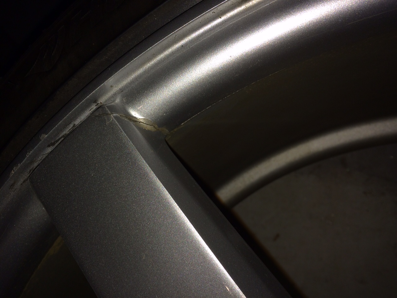

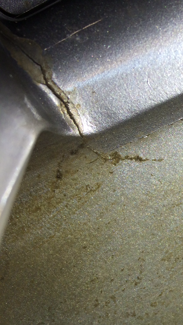

Hey whats going on guys I was cleaning off my summer wheels (Vossen CV3's) and noticed a crack in one of the spokes on my front driver side wheel. Now I baby these wheels and never ride them rough. Even if I did this crack seems to be more structural than anything. Im posting pictures here. Should I be concerned? Can I still ride with them on my G? Thanks

It definitely looks cracked and not just damage to the finish, have the tire unmounted and inspected by a professional is my guess. I don't know if you would be able to ACCURATELY magnaflux a wheel because the dye will penetrate into paint cracks as well, might be worth a shot.
I definitely wouldn't be driving on it until you find out what's going on with that wheel though, a cracked wheel is dangerous.

^^Yeah definitely don't drive on it. You should give a call to Vossen to see what they could do.

Ohh and tell your wheel guy about the crack BEFORE he gets it on the machine to dismount the tire.

The Vossen CV3 had a lot of issues cracking, it was just a bad design. Most were in that exact same spot. Just search Vossen CV3 crack and you'll find a lot of examples. I would replace those wheels immediately and not drive on them, safety is far more important than looks.
They finally released a revised CV3-R wheel a few years ago. It has more material where the spoke meets the barrel.

wheels are fatigued and done! Definitely upgrade to those CV3-R or replace it with another wheel..
