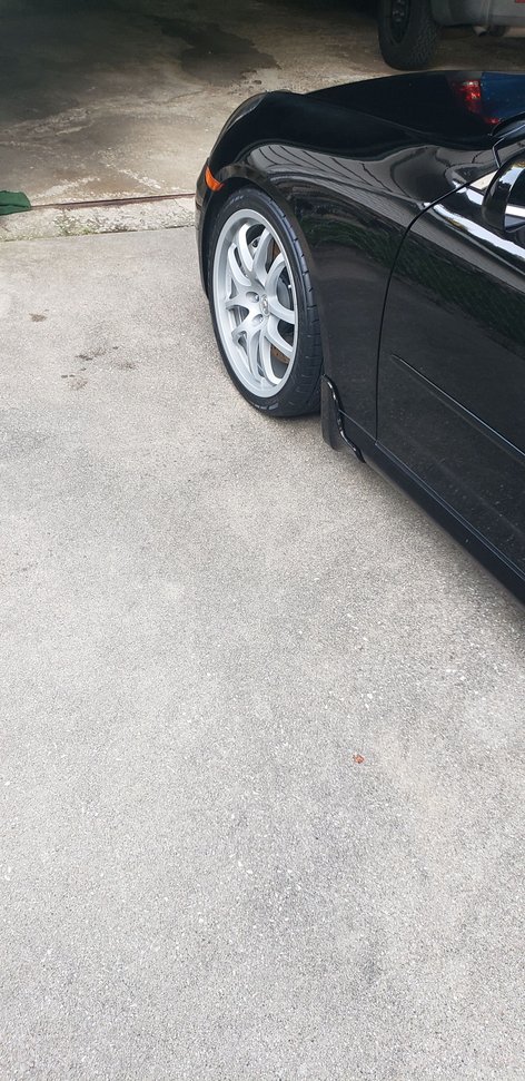

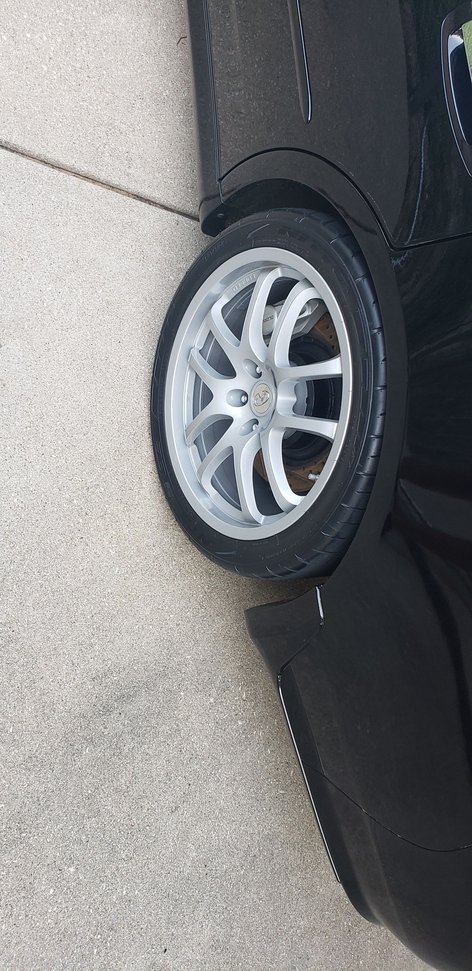

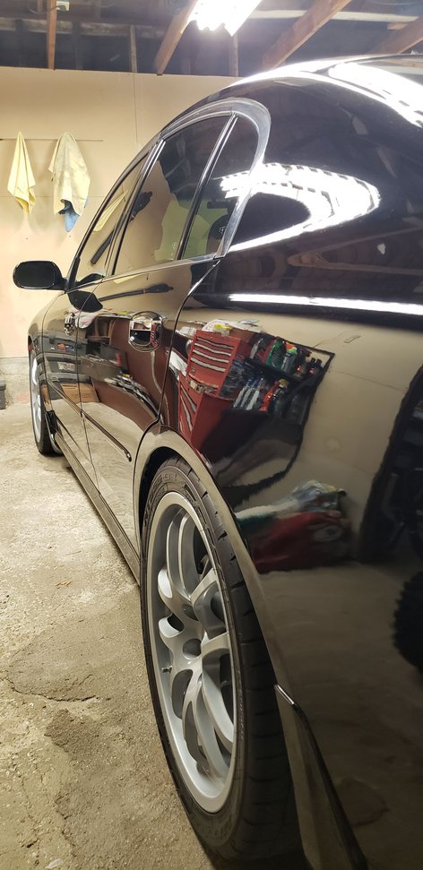

Originally Posted by deuce189
So i bought a spare set of rays for essentially an occasional track setup but still plan to drive on the street when i don't have my volks on. Does anyone have have any thoughts on a more aggressive tire size that won't make my speedo all wonky. Wanting to get a wider tire than stock and want to know what others have run that's different from the factory recommendations.
I've ran 245/35/19 front 255/35/19 rear, now run 265/35/19 rear but there's a lot of sidewall flex/slop/roll. Fine for street i don't know about track.

From: South Bend, IN
245/35/19 front, 265/35/19 rear, nitto nt555g2.
Yes 19x8 front and 8.5 rear. I run the look-a-like, non-forged 18x7.5 square with 235/45, 20mm front and 25mm rear spacers, in the fall and spring. Parked when it snows.
