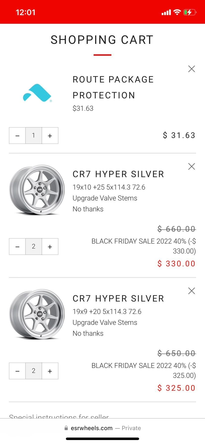

Hey guys, so I’m looking at picking up some esr wheels w the sale they have going on. I’m thinking of buying some 19x10 +25 for the rear and 19x9 +20 in the front… anyone have an idea of how they would fit?

How low are you currently, and do you have adjustable arms to run negative camber to tuck the wheels? Those are positive offset specs for such wide wheels, afaik they’d be tucked in.

Right now its give it take 1" off the floor on 18s, going to be getting adjustable arms soon once the wheels come in;

Would i be able to run spacers to get the fitment more flush?

You will, but it’s ideal to just order the wheels in the size so you don’t wear the bearings as fast 😅!

As long as you're not more than 25mm (1") spacer it's not TOO much extra wear on the bearings, but yes there is more wear. I would draw the line at like 35mm though for a sports car. The biggest limiting factor is rubbing on the fender.
To put it in perspective, off-road non-highway use on Tacoma's and Wranglers it's basically a MINIMUM of 1.5" spacer and can go up to 3" but that's very uncommon. Everyone runs 1.5" Spidertrax spacers on a Wrangler or Tacoma though, on road or off road. Most folks run 1.5" on road and swap them out for 2.5" when they're off-roading.
