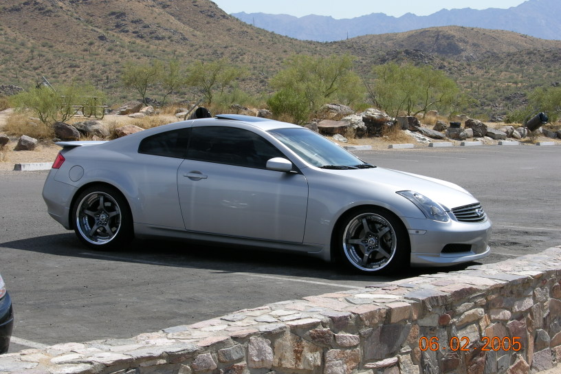

Also, can someone post a side shot photo of SF-Challenges on an 05 coupe on stock suspension?

thats about right man
do you have brembos?? what yr is your g ?

Actually that is my car, he was just kind enough to post one of my pictures for me. I had the 28/23 setup on mine. More pics at www.cardomain.com/id/phxblue.
Oh, ok. I still think that car is bangin'! After seeing your car, I searched for similar rims but did not come across any gunmetal ones for sale ?? Were yours painted after you purchased a set?

Mine were purchased just as you see them from www.350zonline.com
