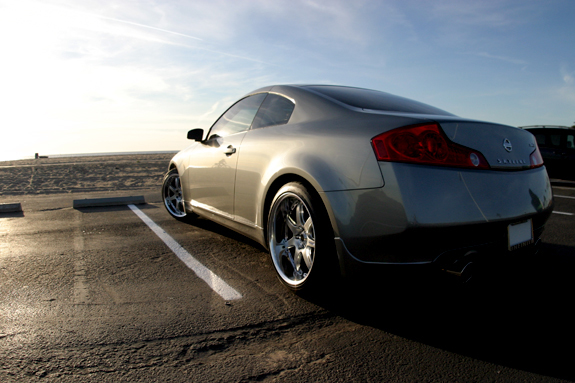

I have +24 all around with 9.5/10.5 volk gt-7's... should be cool!
Attached Thumbnails May have just purchased wheels with wrong offset (Brembos)-5.jpg
