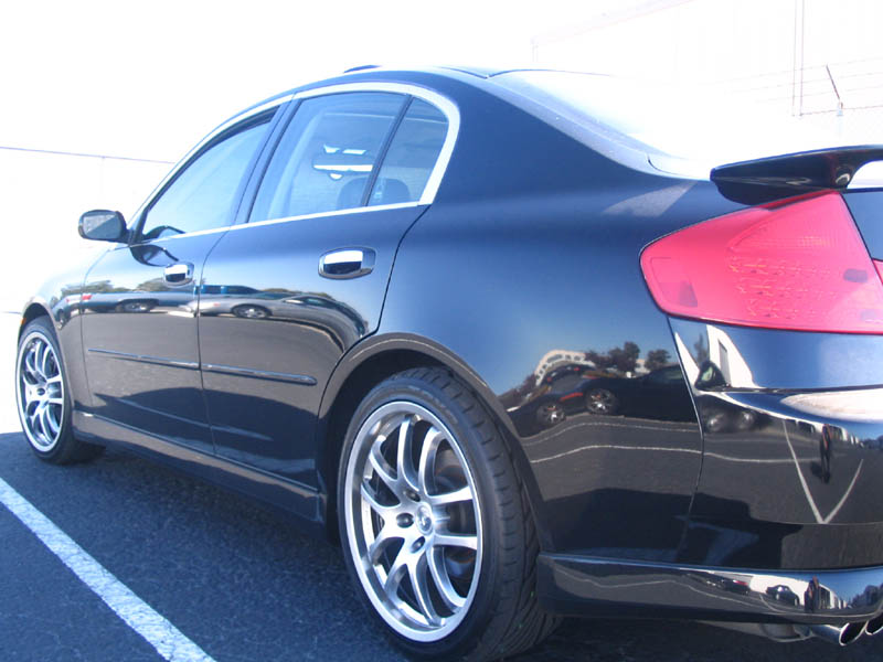

Here's a pic of 05 coupe rims on my 03.5 6MT. The angle may be a little better to see the fit.

is that lowered in anyway? i was planning on getting those wheels + adding tein s-tech springs, or would it be too much of a drop?? if so is the h-tech worth it? i just dont want a huge gap.

No, not lowered. Stock 03.5 MT sport underpinnings.
I'd like to lower it about 3/4" all around for visual effect, but between the $ to do it and keeping the nose from dragging in steep driveways, I'll probably leave it as is.

No rubbing at all? Even with people in the back and hitting a bump? I'm thinking about doing the same thing, but just want to make sure that the minimal offset isn't going to be a problem. I also want to be able to lower it to get rid of some of the wheel gap, and don't want to worry about rubbing.

Jenn and elfsblackg35:
What tires and tire size are you running on those 19s? I'm also interested in this setup but want to avoid rubbing. I assuming anything bigger than a 245 would probably cause some rubbing.
Old Jan 26, 2006 | 01:32 AM
  #23
elfsblackg35's Avatar
Joined: Jun 2004
Posts: 9
From: SF Bay Area, Ca
No problems with rubbing. Plenty of clearance with *unmodified sport 6mt suspension*.
Tires are 225/40 in front and 255/35 in back (stock for these rims on the coupe if I'm not mistaken). Sizes are very close to the stock tires in diameter, so no problems with the stabilty control. Poke around the tire/wheel postings on the tech board, there are several nice tire size calculator locations posted, that's how I dialed in on these.
NOTES:
1) These are a full set of staggered size coupe rims, not one size all around. 19x8 F, 19x8.5 R.
2) These are the same tire size combo as Boxster, so the sizes are a little more pricey than some other combo's.
Noticed a slight increase in road noise transmitted on very rough road surfaces compared to the stocker 17" Goodyear's, but in day to day service, nothing to complain about on the NVH scale. Turn in and feedback is significantly better.
PLEASE post some more pics: side shots, 3/4 fronts, one from the rear flat against the car looking forward and vice versa.(one from the front, flat looking to the rear) etc
Nice car, nice aero-kit
what is the price of those wheels, and the price of those tires?
Thanks

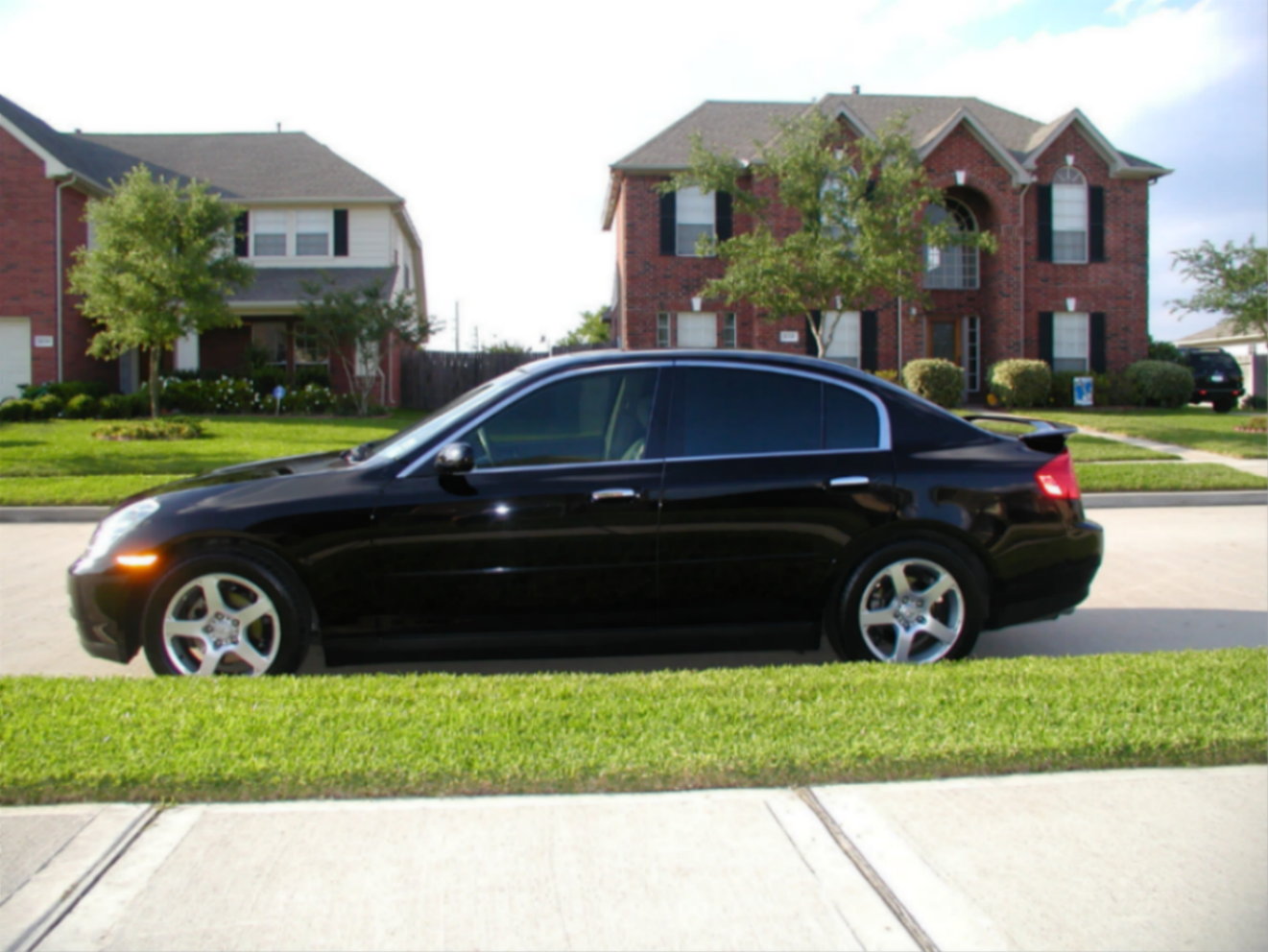

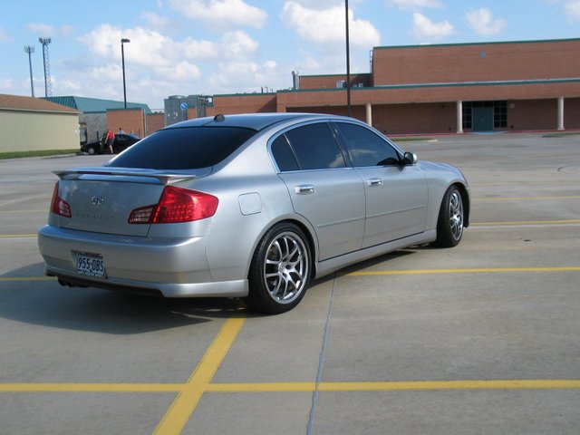

Originally Posted by Jenn
I have the 05 coupe wheels on my sedan with Eibach Pro Kit 1.1" drop. I haven't had any rubbing, still have a small fender gap. I like how the back wheels stick out. I have pics posted in the "New Owners" section the thread is a little old but it's titled "Hey guys new here" might have to search a little for it but it has pics of different angles so you can see the difference.
Hi Jenn--Your car looks fantastic. I eventually want a black version of yours, like elfsblackg.
Went to "see all threads started by jenn" and found your pics easily--thanks
https://g35driver.com/forums/new-members-check/76410-hey-guys-new-here.html
My black g in the middle, and what I want mine to look like on the right--elf's--maybe with a slight drop.
Maybe I would go with coupe or 350z springs for a drop in between yours and stock
Attached Thumbnails 19" OEM G35 Coupe Rims-129_2998.jpg   19" OEM G35 Coupe Rims-p1010061v2.jpg   19" OEM G35 Coupe Rims-elfsg35.jpg
