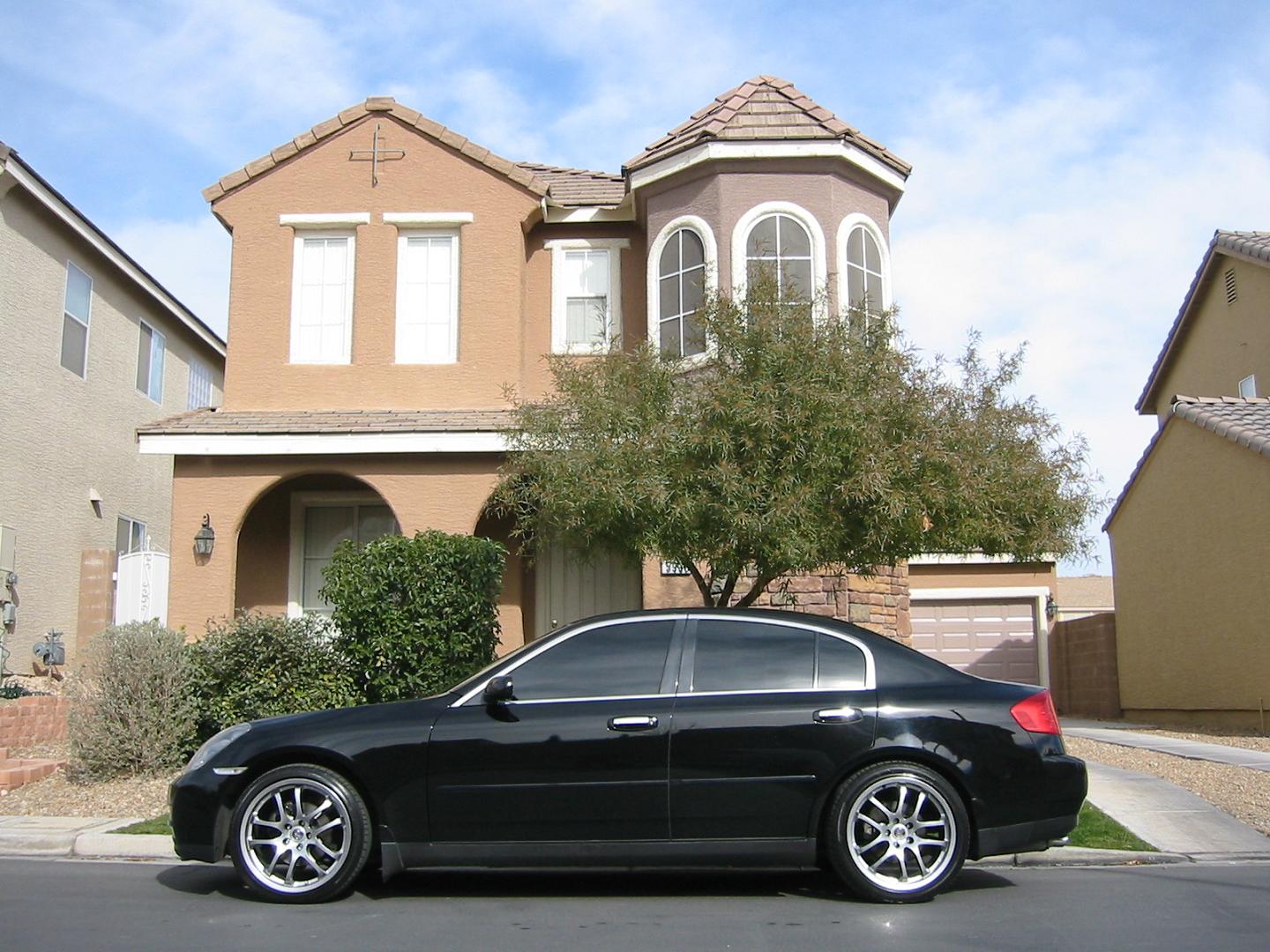

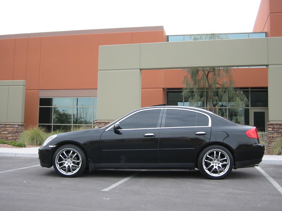

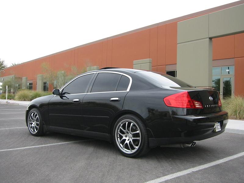

Here is my 04 sedan w/ the coupe 19's on.
Stock non-sport suspension
Yes, the rear tires did rub, but rarely and just the slightest bit.
