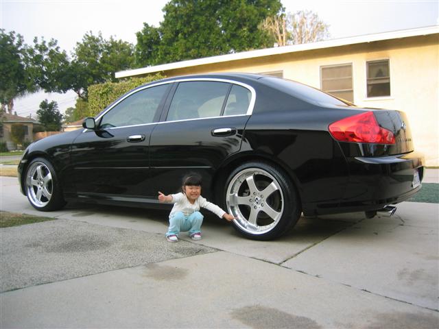

Yes....those are the 19s in the front and back. I know, cuz it's my car .
I rarely get time to post, so it was nice to jump on and come across a pic of my car!
I have Z front springs, and coupe rear springs. I can't remember if the pic was before or after I lowered it. Sorry about the bad pic. I can't take new ones, cuz I sold the wheels.
If you plan on lowering, beware of rubbing issues. I believe I was rubbing with the coupe springs in the back (0.5 inch drop).
EDIT: the pic IS after i lowered it. I have a few other pics. I'll see if I can post them up.

Honestly, I never felt or heard my fenders rub. One day while washing my car, I had some rubber on the inside of my rear fender lip. It wasn't on the fronts, or anywhere else, so it couldn't have been road tar. I've heard about other sedans lowered on coupe 19s with no issues. Not sure how to explain.

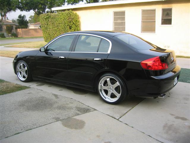

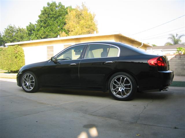

Here's another pic of the 19s. I also attached some newer pics with my newer wheels. The new wheels are staggered 19s also. They're Axis Milanos, but the person I bought them from just had the 2 rear centercaps, but I got some Jaz (same people as Axis) centercaps in the meantime until I get the 2 fronts. The Jaz ones look nice, so I've been lagging on getting the Axis ones. Either way, I like them.
