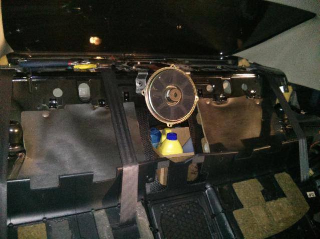

So I decided to tinker around on the G and figure out how I can remove my Bose Amp and Sub. I grabbed a copy of the factory repair manual and had at it, heres what happened...
Didnt snap pics of the Amp removal but its fairly easy...
Remove the trunk lining taking out 6 clips around the top of the trunk, this will reveal the Bose amp on the left. Take a ratchet and unscrew the 4 bolts, the back left one will be a pain so use an extension to get to it.
Now for the fun part...:newangel:
Got my laptop with repair manual up, phone ready in case of emergency (couldnt see one possibly happening but safety first...)
First, remove the head rests...
Next pull down the center arm rest and pull back the leather that is velcroed to the back of the opening to reveal a few bolts and a clip holding the arm rest in... (These bolts and the bolts in the next step are very tough to loosen, I had to use my entire body weight to get these to budge)
Pull out the arm rest and this will reveal 2 more "impossible" bolts holding the two seats in place, take those out...
Next the repair manual shows that the seat reclining mechanism needs to be removed shown here as the black piece in the corner of the seat..
What the repair manual doesnt tell you is that behind that plastic piece there is nothing... notta... But the chair is still secure in place. I searched for an hour hoping that I missed something... Even did some painful tugging and maneuvering of the seat, hoping not to tear it, but still find something. But all for not...
So the next obvious step for me...
Not worth the money I would get selling that stupid sub...

pop the bottom seat up. other then the bolts you removed there should be ones on the sides aswell where the bottom seat cover was. lift up on the seat back and remove

Yes remove the bottom seat and remove the 2 bolts and they come off!

Did it in 1 hour....thanks for your post
