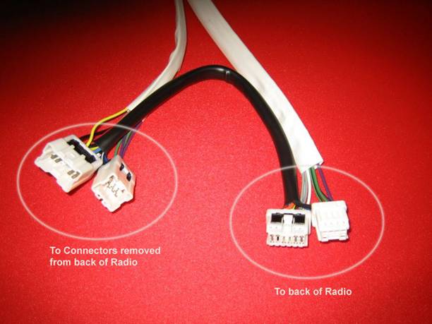

Hey fellas. I wanted to install a parrot device in my 05 G35 with Bose. I want to use the quickconnect harness
Possible to install Quickconnect for Parrot AND PAC adapter?-quickconnect.jpg

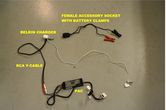

so that I don't have to mess with the wires. I also want to add an aux input for devices with a 3.5mm output (like an iPod or whatever). There's a pic of the PAC device:

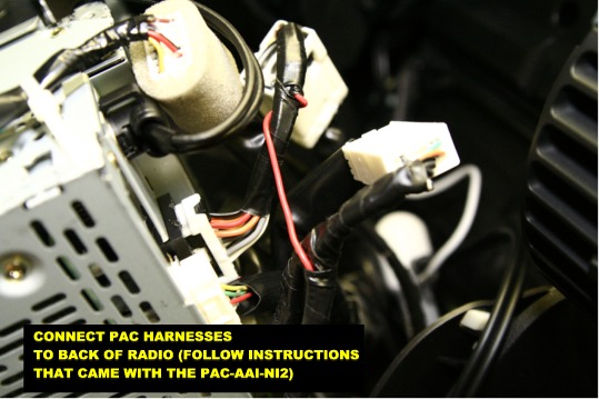

The back of the radio:
So based on these pics and what you guys know, can the PAC adapter and the quickconnect harness be used at the same time?

Even though the harness goes to the trunk, it still uses the aux audio ins on the head unit. These ins are used for either a CD changer or the SAT. So if you have multiple sources you'd like to go into the head unit, they all need to run through the PAC.
I'm not sure how the Parrot works with Blose HU, but on my old Apline HU it had a interrupt mode and inputs that was just for the purpose of a phone interrupting the stereo. I'm assuming for 06 they added this option for the built in bluetooth, but not sure about the 05.

The two harnesses can be daisy chained. PAC just uses the 10 pin connector for power. The HBBH-1 and Parrot kit should be blissfully happy. Howard
