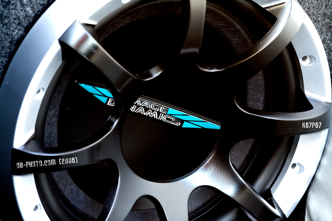

Old Sep 16, 2006 | 12:20 PM
k67p67's Avatar
iTrader: (86)
Joined: Dec 2005
Posts: 2,499
Likes: 20
From: Rancho Cucamonga, CA
Originally Posted by limeg35
Sorry, did not know that, whats the mounting depth on IDMAX? is it as deep as W7's?
7.625" Due to the size of the magnet structure and the angles of the 4080 enclosure, I needed to add two 0.75" spacer rings to accommodate the IDMAX. After spacing the driver out the additional 1.5", I was unable to utilize the nice flush grille that is supplied with the 4080. I had to modify a Polk Audio Momo grille. It doesn't look nearly as clean as a JL 10W6v2 application but I really wanted to run the IDMAX.
