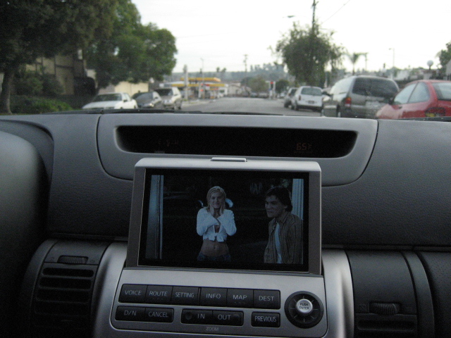

alright you guys here are couple pix from my installation
looks great, quality is good enough for me, for a stock unit.
Attached Thumbnails DVD player and back up camara installed, need help.-img_0935.jpg   DVD player and back up camara installed, need help.-img_0936.jpg

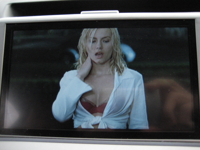

for some reason the resolution doesn't look as great as it looked in reality,
when your really watching in the car, looks 2 times better than that
i tink when i attached it to forum, must've automatically resized it

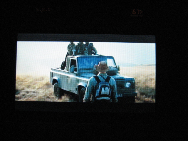

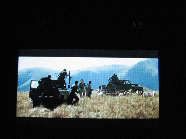

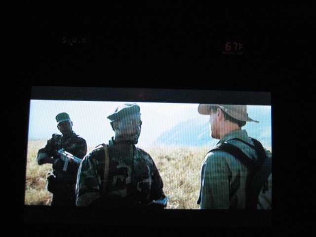

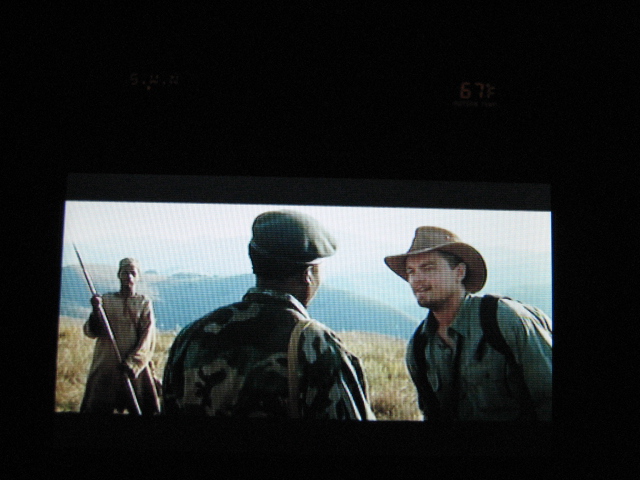

heres the one at night pix
Attached Thumbnails DVD player and back up camara installed, need help.-img_0942.jpg   DVD player and back up camara installed, need help.-img_0939.jpg   DVD player and back up camara installed, need help.-img_0940.jpg   DVD player and back up camara installed, need help.-img_0941.jpg
