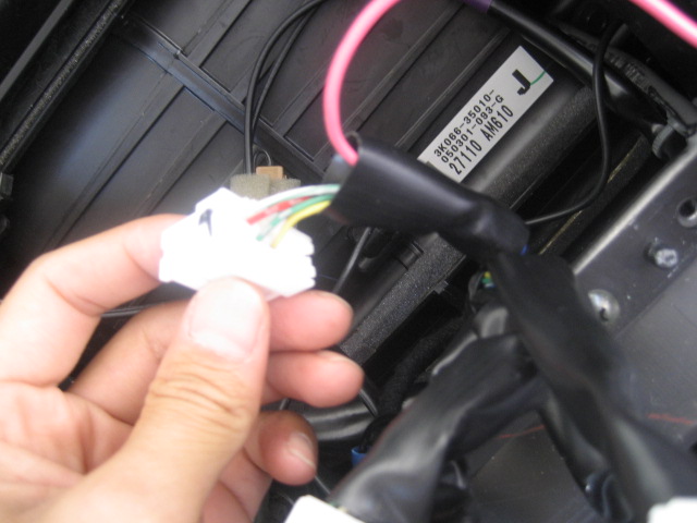

I have a Z1 but I think it should be the same wire harness. So...ok after you plug your D3 in, you are going to use two group of wires, there will be two more group of wires left, one for the ac controller and the other has VSS wire on it. I think its green with white stripe. I will post some picture for you later.

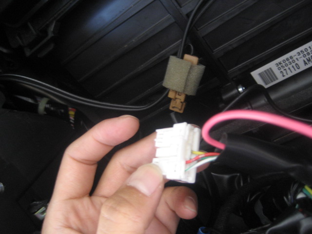

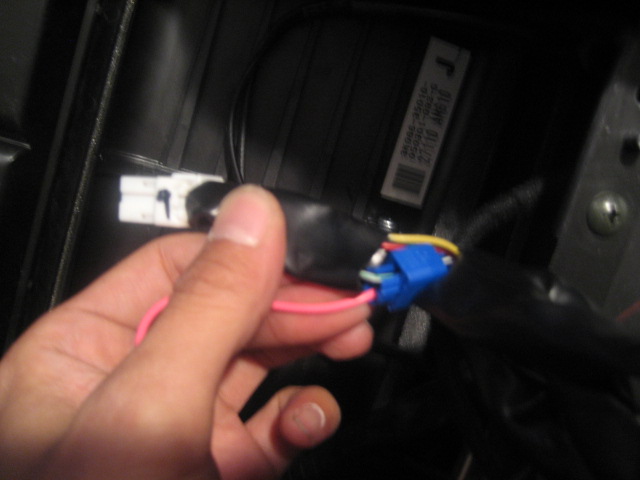

This is where i found my VSS wire as you can see the pink wire that I have connected.
Attached Thumbnails Ok, so where is the VSS wire plug-img_0953.jpg   Ok, so where is the VSS wire plug-img_0954.jpg   Ok, so where is the VSS wire plug-img_0955.jpg

O ok I see. It's the M19 not M39 plug. Thanks so much for taking the time and posting pics JT. Now for that reverse wire.... (in the future I want to installa backup camera)
