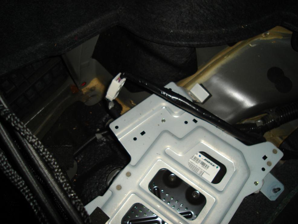

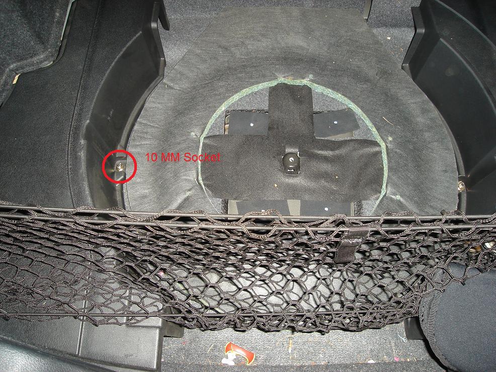

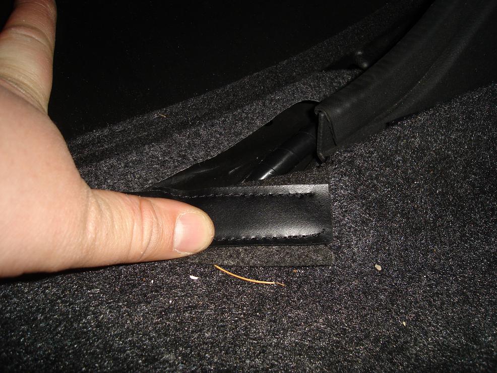

Step 1 - Empty Trunk and remove Drivers Side AMP Cover. Take youre golf clubs and crap out of their along with the mat and the spare tire. On the Drivers side is a plastic cover held on by a 10MM bolt. Unscrew the bolt and take the cover off. You will be looking at the AMP, along with the factory SAT radio hookup held on with some breakaway tape.

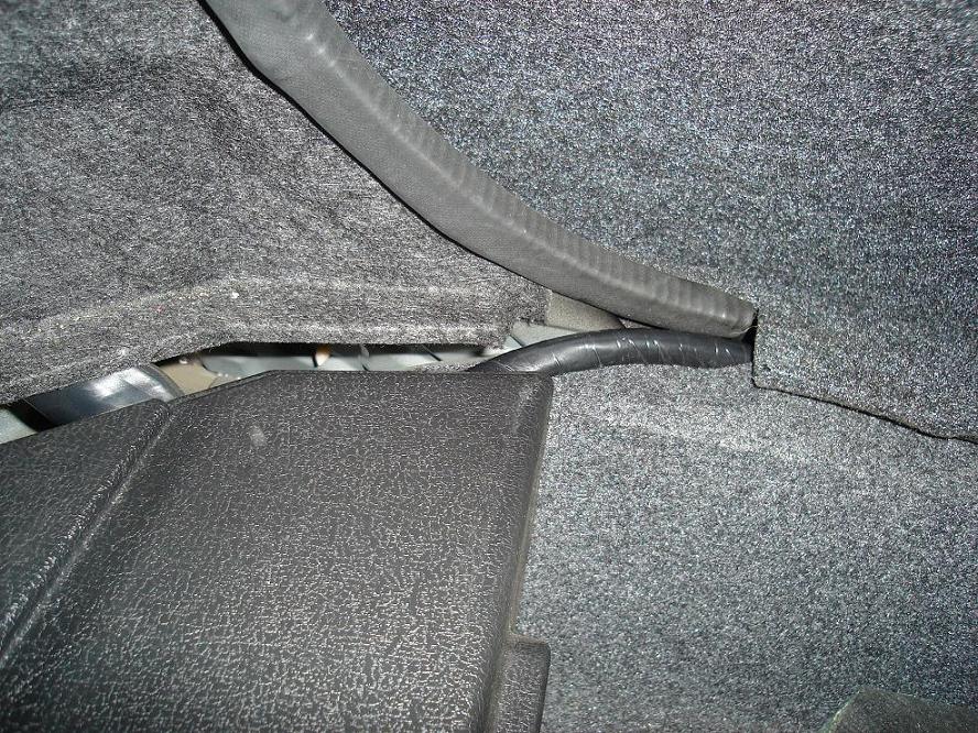

Step 3 - Attach factory harness to SAT hookup. In the trunk, attach the factory SAT harness to the harness from Everything G35. You will then run this wire along the drivers side and tuck it under the carpet and the rear seat so that it comes out where the rear center console is.

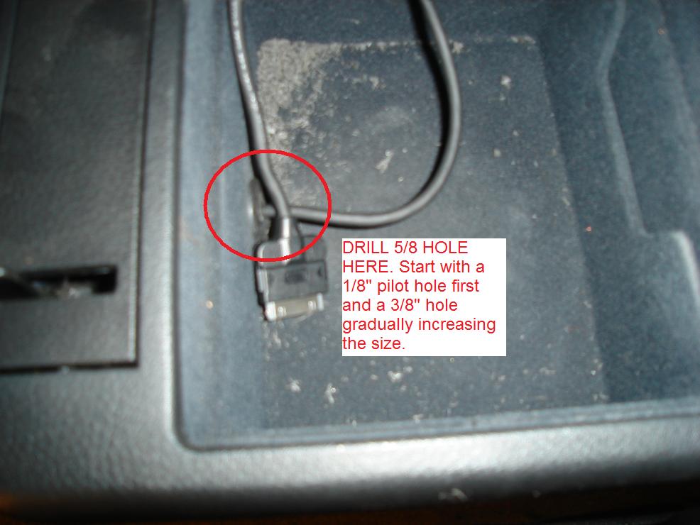

Step 5 - Drill hole in console. A little frightening at first but trust me, you'll get through it. Start with a small 1/8" pilot hole and gradually work up to a 5/8" hole. You will be fishing the round end of the Ipod wire through the hole and under the carpet leaving the iPod dock hookup in the console. You may need to work the hole a little bit to get the wire to fit as the round connector pretty big. Once you have the hole drilled and the round wire through the hole, insert rubber grommet from the kit in the hole and use a set of needle nose pliers to push the grommet around the edges of the hole. The grommet is pretty big so you can actually fill a pretty big hole. Try to make the hole as small as possible. If the round connector fits through then it is just big enough.

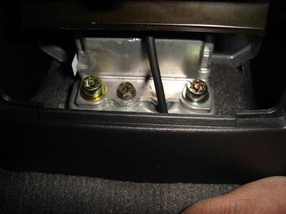

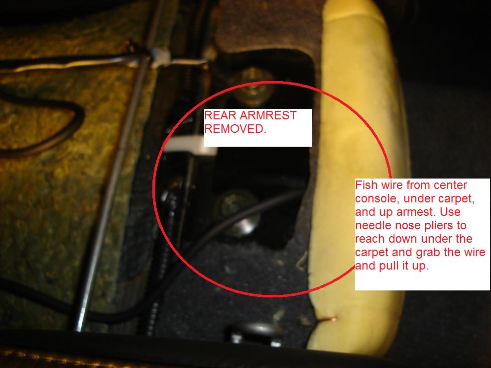

Step 6 - Fish the bloody wire. So I didnt't want to remove the back seats and I didn't want to remove the whole center console as I am very very lazy. So I found some stiff 8/2 wire and used that as a fish wire under the carpet from the center console to the rear seat console. Basically I felt the wire as it moved under the carpet, cursed and swore at it, then guided it to the rear where I could lift up the seat frame a little bit and get a pair of needle nose pliers in-between the carpet and the rear seat frame. From here I pulled the fish wire up, attached my iPod cable to the end sticking out of the center console and pulled it through. This was the hardest part and took me about 20 minutes in total.

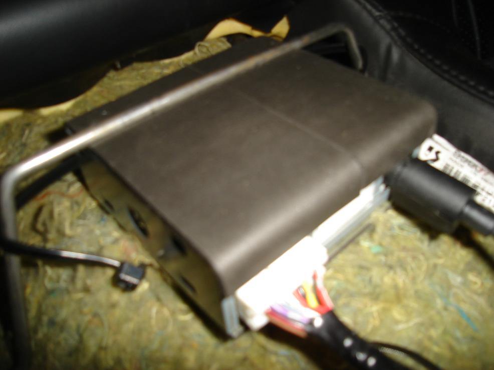

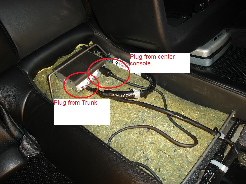

Step 7 - Secure the iPod unit. The kit from everythingG35 comes with a big piece of doublesided foam. I used that to secure the unit to the padding. I then placed 2 pieces of the sticky foam to the top of the unit and positioned the unit under the rear wire frame where console attaches. I figured this is the most solid place back there since it is physically under a hard piece of metal which really can't move and wrapped in foam.

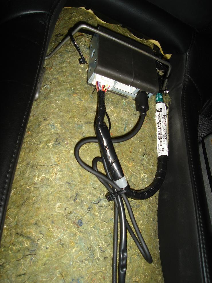

Step 8 - Attach wires. Just attach the remaining wires from the trunk and the wire you fished from the center console.
Step 9 - Secure wires in place. I used a couple of the big wire ties to secure the unit to the middle of the rear wire frame, and to attach the access wires together so they are neat and contained.

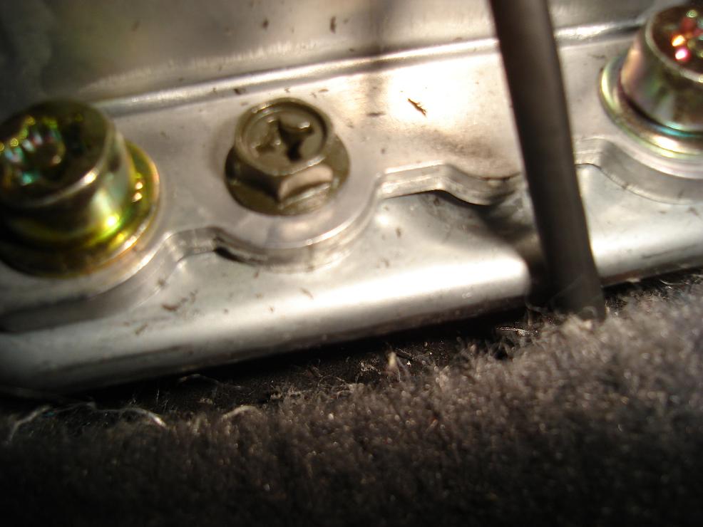

Step 10 - Attach ground. There are 2 big 12MM bolts holding down part of the rear seat. Remove one, and use that as the grounding point. It seems to be right on the frame of the car so it should work really well.

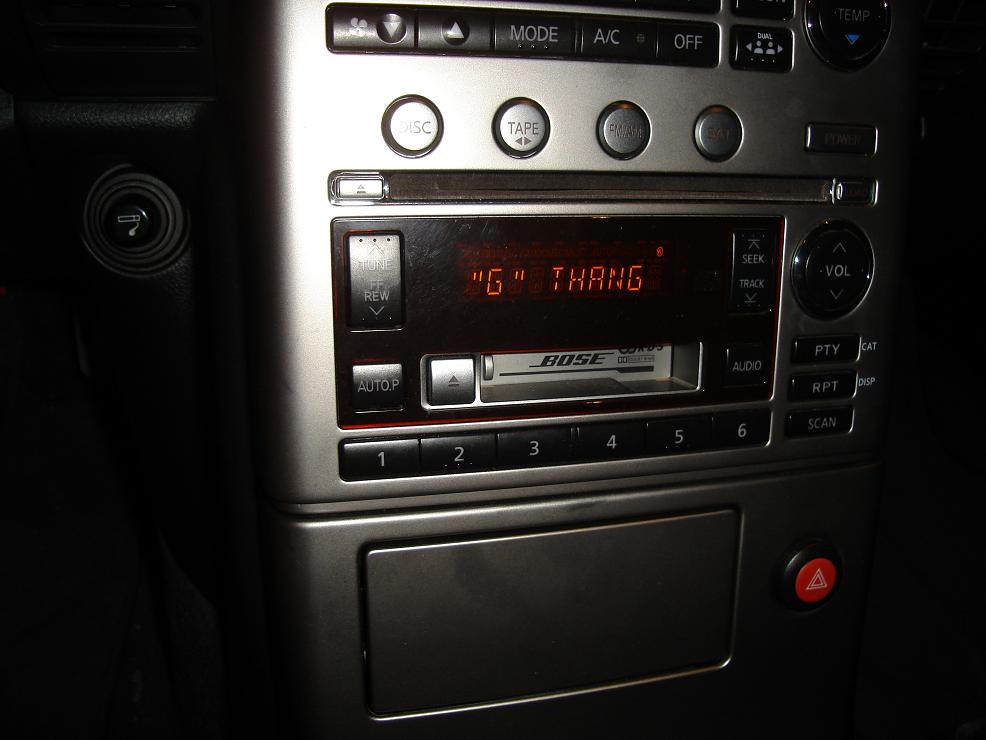

Done!!
Finally play music and point & snicker at the poor saps still fussing with CDs.
