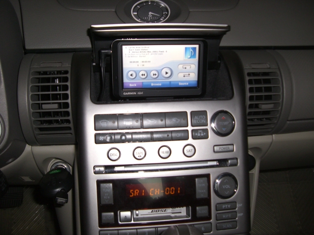

I used the RAM-HOL-GA22 and bolted it in 45 degree. It works fine for my 2004 coupe. I mounted the Garmin 775t. I can open and close it without problems.

Thanks for the reply. I ended up making a mount using a deconstructed ball catch plate (available at Lowes or Home Depot), the sawed off end of my Garmin suction mount (the ball plus about a centimeter stem), epoxy, then mounted with double stick tape.
It worked nicely except that I can't open and close the cubby with the Garmin mounted or the Garmin bracket vertical (have to rotate it horizontal with the Nuvi removed). I think it's because I have the Nuvi 200W, which has a higher profile, thicker mounting bracket (i.e., the front of the ball mount to the front of the GPS unit is a bigger distance than the Nuvis with the slimmer mounts or cradle mounts.
Can you rotate yours left, right, up and down? Could you post a picture?

See the pictures. I also use th Garmin 755t as mp3 player so that I don't use the CD player any more. I also install the PAC AAI-NIS2 for the aux input. The sound from the Garmin sounds really good in addition to the Navigation use. I still can barely close the cubby door so that no one can see it.
I would have put the holes for the power/audio wires in a less visible position, but this is definitely something more people looking for a navigation solution should consider.

I couldn't think of a better place to locate the holes for those wires. Once I mount the navi, the hole is not visible at all from any directions. The cradle would cover the hole.
Thanks for your comments.
