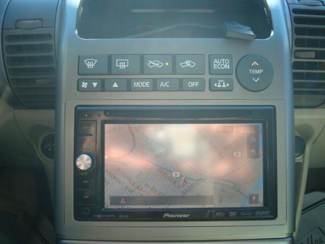

Hey guys just picked up the whip todayy, came with this aftermarket Pioneer. Just wondering if anyone knows anything about this model or about aftermarket installed stereos in general that has some useful info for me.

It's not panasonic, it's Pioneer. Says so right on the front.
Pioneer AVIC-D3. A pretty solid unit. If you want info on the unit and such, there's no better place than avic411.com - http://avic411.com/index.php?/forum/28-d-series/

lol just fixed. thanks for the help, had an aftermarket in my older car...how much does it improve the sound quality ? And do any of u know if it is still hooked up to the stock bose amp or if that was bypassed ?
Probably not bypassed, but you can find out easily by pulling the harnesses out (with the car off, of course!) from the bose amp under the floor carpet in the trunk and then turning the car on and seeing if it still makes sound.
It won't help SQ much if it still uses the bose amp, since the bose amp's EQ totally screws up everything that goes through it.

kk so the sound quality will be better if I bypass the bose amp ? even withough an aftermarket amp ?

I'd say it'd be pretty close if you use the speaker-level outputs from the D3 to power the speakers directly, but I'm guessing that the D3 only has four powered channels, so you'd have to choose between powering the rear 6x9's (that's what I'd do) or powering the rear speakers.

Ok. I have a 2 channel 700w amp at home but can I only use that for subs ? in other words do I need to get a 4 channel if I wanted a new amp to power the speakers ?

If you're going to be doing anything beyond what the previous owner did, check to see what else was done before you make your decision. Most likely he only changed out the head unit and left it running through the stock to the stock speakers. If that is the case, and you want to improve your sound your best bet will be to add aftermarket speakers as well as amplification. Adding an amp to the factory speakers is going to cause a good bit of work for very little, if any, improvement in quality. If you're going to take it all apart, put something good in there before you put it back together. The Pioneer is a pretty decent head unit, so at least that part is already done
