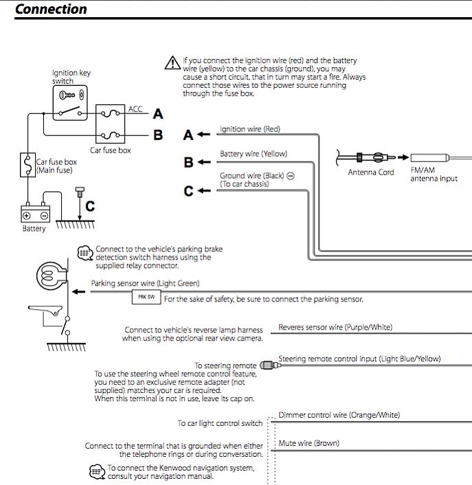

for the people that installed a dnx7120 or similar with a reverse camera. Is the video spouse to show up on the screen when the car is in reverse? I hooked up the reverse sensor wire to the reverse lights and nothing happens I even tried testing it to a 12v source and it still wouldn't show up on the screen unless I push the RCAM button . I want it to pop up right when the car is in reverse on its own.

I wired the parking sensor wire (light green) to ground so I can watch movies/ music videos while I'm driving.

For mine I bought the video bypass and went blue-white from radio to blue on bypass, light green on radio to green on bypass, and then tapped into the ground...the NAV works fine, DVD plays whenever, but I think it's the Kenwoods themselves that makes you have to switch between screens, because I have to also!
FYI, the video bypass is only 7 bucks off EBay and it's gotta quick turn around!

It's only $7 because its a rip off just ground the light green wire and ull see ill do the same thing

I attempted taking that route and it didn't work for me, which is why I got the bypass lmao?! I tried grounding directly to frame, as well as just catching another ground wire and neither were successful...what would the purpose of the blue/white wire have in it then??
