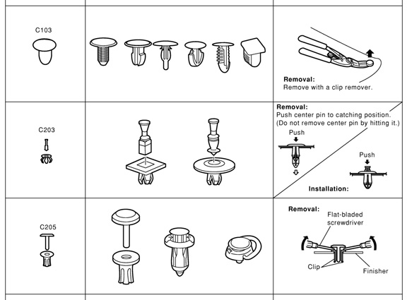

It is in trunk under passenger side parcel shelf. Remove seatback and top trunk finisher panels. The pop fasteners are easy to remove with two flathead screwdrivers. The flush ones are a bitch if you don't have the proper tool which name escapes me right now. I used side-cutting wire cutter to work under both edges and then pried up with even pressure on both sides of plastic flange. You have to keep at it. They don't get easier as they come out until they completely release. You'll see why when you get the first one out.
If it was a dealer installed accessory, it's possible it's mounted to the back of the seat.
You are looking for the big rectangular white plug.

PS: The tool is the "clip remover." You will encounter five C103 clips [the specific one is the first (left) one in the center column] -- two in the seat back flanking the access door, and three across the top of the assembly that are hard to get at among all the seat belt housings, speakers, amplifier, and whatnot. That's where the clip remover is most helpful. There will also be about 10 of the center C205 clips spread around. They are very easy.

One more thing: start with removal of the top trunk liner. If your sat unit is mounted to the underside of the package deck, you won't need to remove the tough C103 clips. If it was dealer-installed and is mounted to the back of the seat frame, then...sorry about that....
