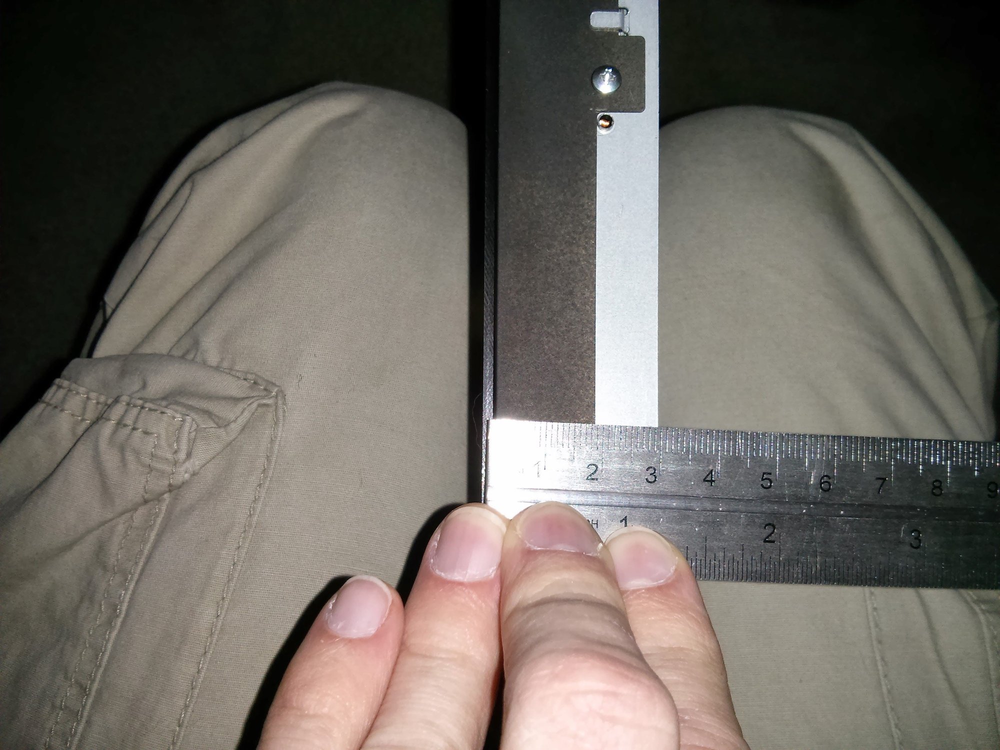

Here are some measurements for anyone looking at what they can put in the location.
For the screen, there's the screen with housing, and the opening for the visible screen.
Screen housing:
Width - 17cm
Height - 10.5cm
Depth - 3cm
Screen opening:
Width - 16.3cm
Height - 9.3cm
There's also an adapter box that is not visible, this is the part that the main harness plugs into at the back of the radio.
Width - 12cm
Height - 6.3cm
Depth - 3.4cm
The motorized screen elevator is powered independently from the screen, so once you've removed the screen housing and adapter, it will continue to pop up and operate as usual, just empty.
