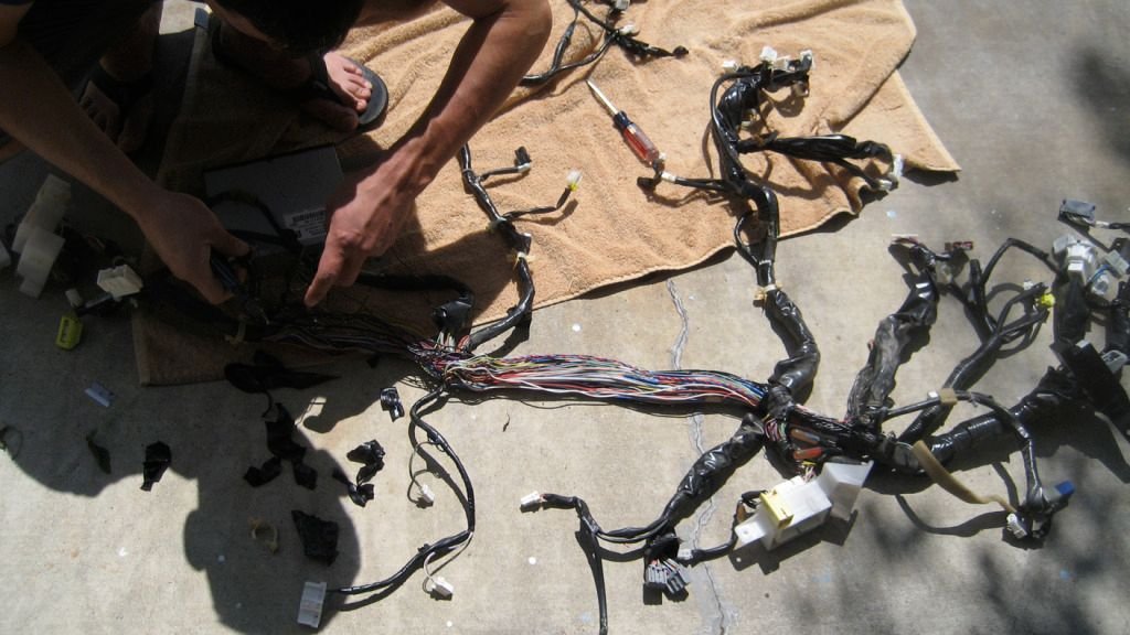

This is the harness you have to install - it's the entire dash harness, not just one that goes between the unit and the radio.
This is the minimum level of dash disassembly you have to do in order to install that harness:
If you don't feel like disassembling both cars' dashes to get the complete harness out, and just cut a chunk from the donor car, you still need to disassemble yours to be able to solder the wires into the existing wiring harness, plus you have some nice meticulous searching and soldering in your future.
