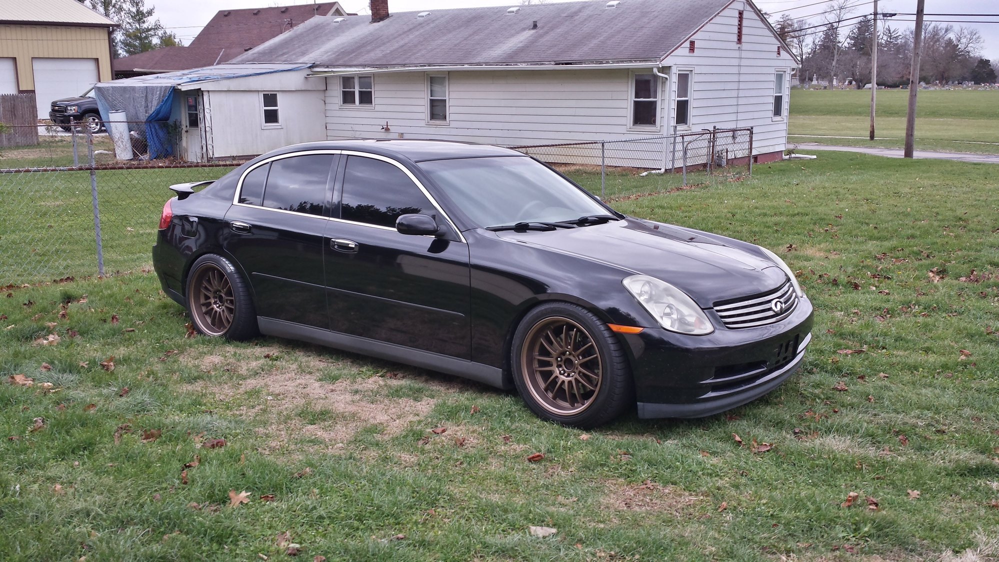

One day I will put in an actual sub. I'd just like to get everything working on this car. It's got almost 300k miles and I'd still in really good condition.

Agreed. My car has very little rust. Just a few spots from rock chips on the hoof and such. had to put in a different engine due to failing head gaskets though. I'm just trying to keep everything working in the car.
