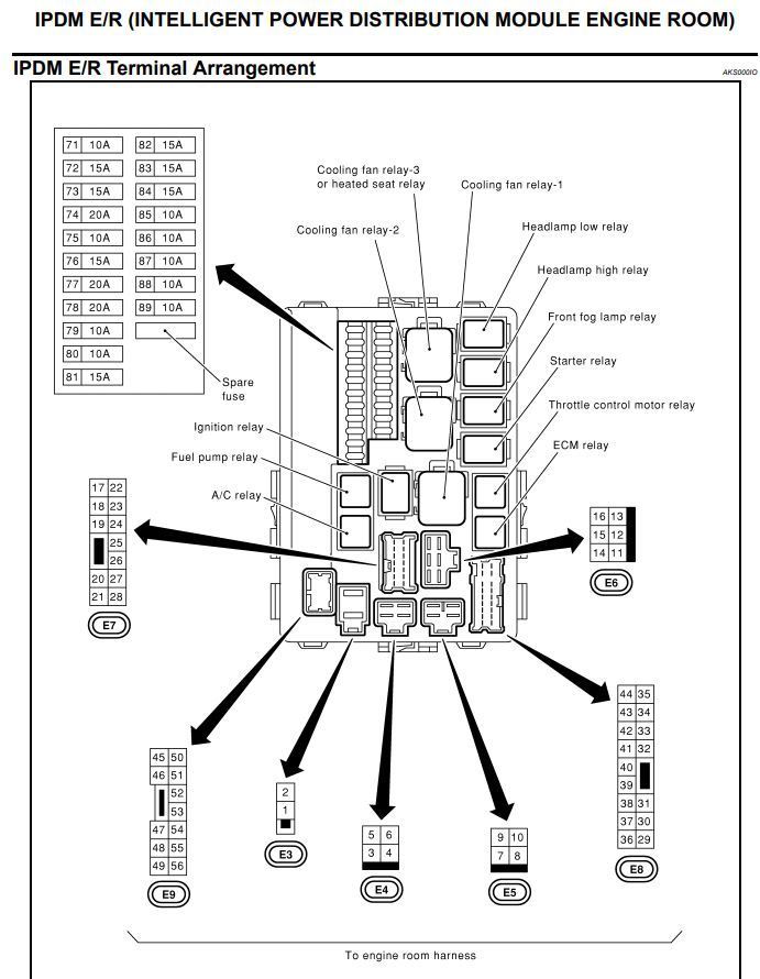

Ok you need fuse 88 in the IPDM and fuse in Fuse Block - J/B if you have a 2003 sedan. Yes the orange wire should have 12 volts I was wrong about it all being data. Here's 2003 sedan stuff.

Appears to be the same for 2003 sedan AND coupe so those latest snippets should work.

thank you, i just double checked those and both are working however fuse number 20 in the j/b is labelled in the diagram as a 10amp but there is a 15amp in there..
