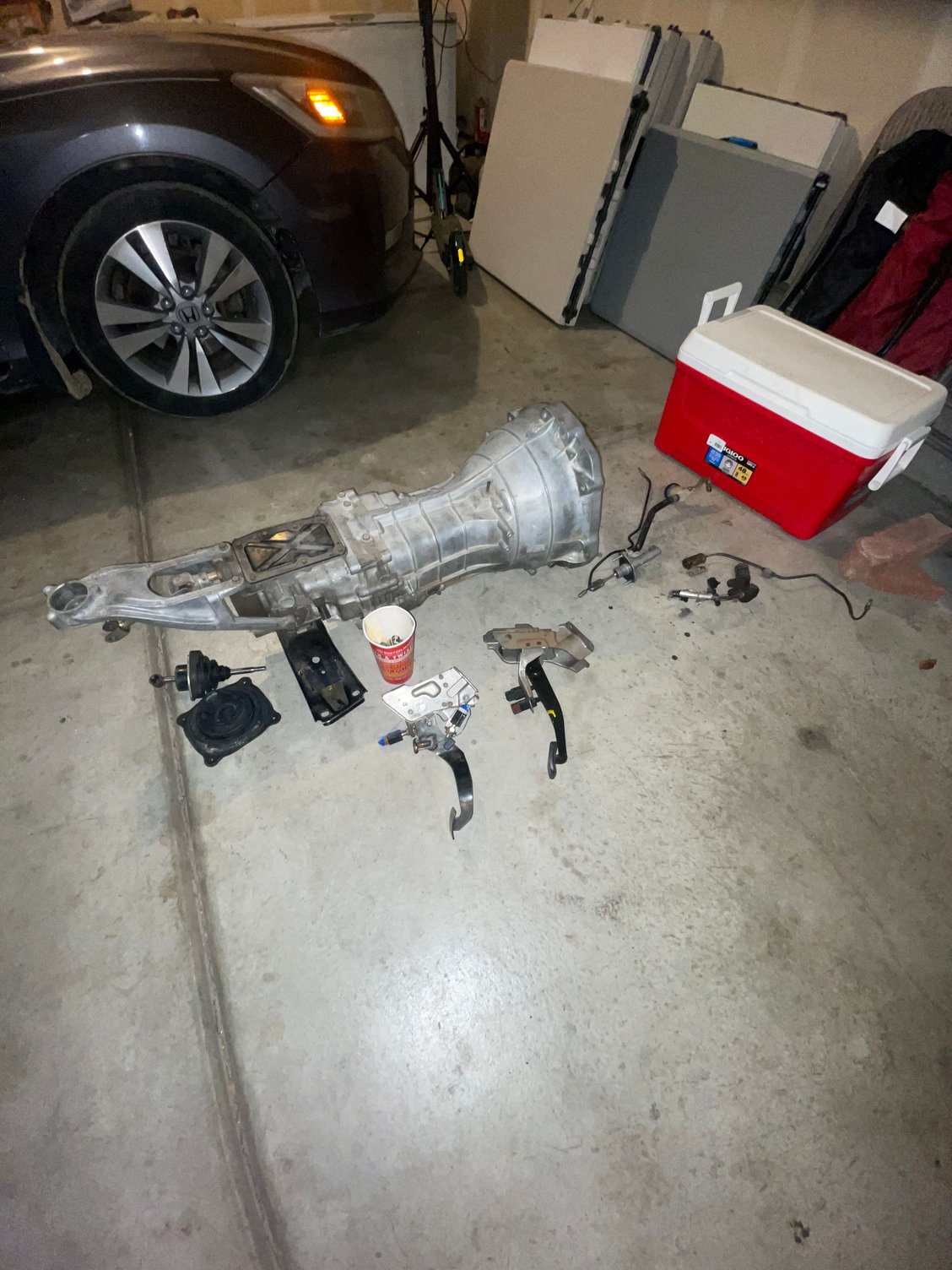

Ok I did the swap. I’m using auto harness and auto ecu. Only thing I wired was terminal 53 to crank the car. The car started and worked fine, I got u1000 code and P0850 for PNP. So I drove the car for a month or 2, NO PROBLEMS. So I decided to wire the PNP and reverse lights so I could use cruise and have some sort of safety when backing out of a Parking space. But when I wired everything up and tried to crank the car, it only cranks and doesn’t start. Only codes I get are u1000, I know nats isn’t at fault due to my security light only flashing when the key isn’t in the ignition but will go away once the keys in it. When I crank the car I get no signal to tach(stays at 0 rpm). What do you guys think? Did I accidentally fry my ecu trying to wire that stuff or do I might need a new crank sensor or what? What I’m confused about Is how perfect the car worked before. I even tried to wire the car back to how it originally was but still crank no start.

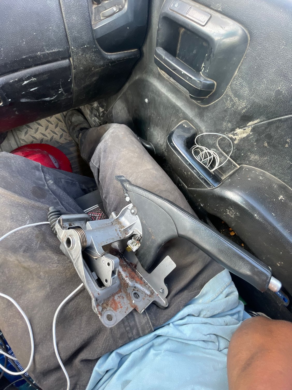

it runs great, starts up fine and everything. I know the ecu recognizes the MT harness because 1. car won’t start if it’s in gear 2. Car revs up slightly when put into gear. I’m still confused on why I don’t have reverse lights, I’d might just have to manually wire them. And also I still don’t have cruise. From what I’ve researched in order for cruise to fully be functional the system needs to be fully connected(no **** Sherlock) but what IM missing from my system is the CAN signal the cruise control system gets from the auto transmission. Does that make sense? Anyway I can fool the Tcm to think the system is complete allowing cruise to work? But At this point I don’t care about cruise or the reverse lights I just need to know if I can remove these dtc codes to pass inspection. I know u1000 is from manual swap bc Tcm doesn’t get signal from auto transmission, but I also have p2a00 and p2a03, not sure why. Maybe my cats or intake leak, the car runs fine so I don’t bother trying to fix it, from what I remember my car has always had these codes. I always just cleared them and drove the car enough to pass inspection but not drive it long enough for codes to come back. But since manual swap I can no longer do that because u1000 code doesn’t go away for ****. Any help?
I’ve practically done the whole manual swap, I just need to pass inspection. If anybody needs help with hand brake or clutch pedal or anything about the swap, I can for sure help. I went thru hell for it lol
