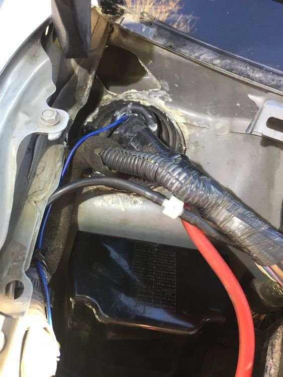

Old Feb 16, 2022 | 02:30 PM
Scorpi0's Avatar
Joined: Feb 2018
Posts: 3,087
Likes: 445
From: LA, Cali
I have mine poked through the rubber boot where all the other electrical wires come through. Under the hood, on the passenger side. I just poked a hole in it and pushed it through. Just make sure to add some extra sealant around the hole to waterproof it good.

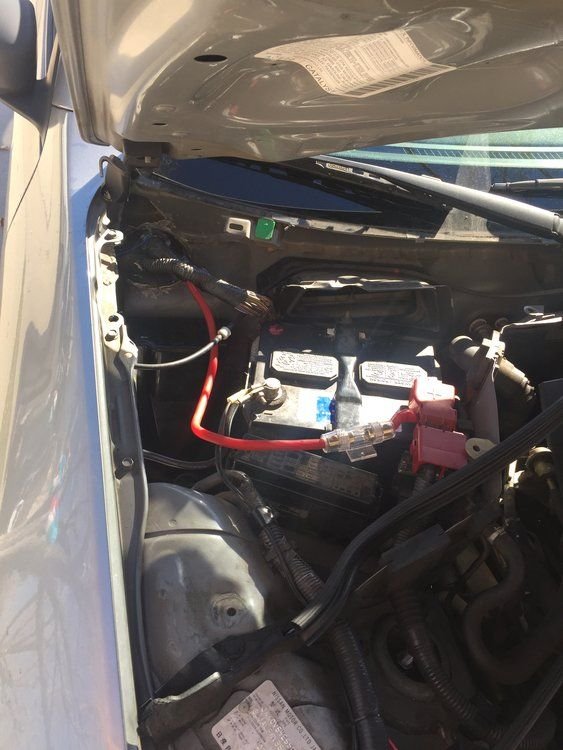

Old Feb 16, 2022 | 04:10 PM
Coupe de Gray's Avatar
Joined: Feb 2022
Posts: 15
From: SF Bay
G35 coupe
Ok, cool. Where did you put the fuse? Near the battery?
Last edited by Coupe de Gray; Feb 16, 2022 at 06:46 PM. Reason: Answered my own question
Old Feb 16, 2022 | 10:07 PM
Scorpi0's Avatar
Joined: Feb 2018
Posts: 3,087
Likes: 445
From: LA, Cali
Yeah right here
