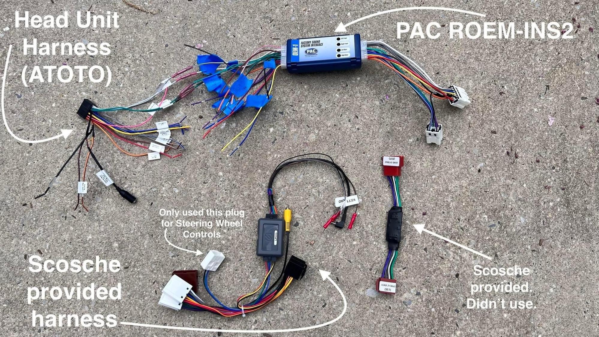

I'm in the process of installing an ATOTO F7 WE in my 2003 G35.
I'm following Wrathernaut's double din install guide and noticed I needed an AWSC - 1 for radio controls.
It turns out my Scosche kit has steering wheel controls in the kit.
Would be it safe to return my AWSC-1 and stick with the Scosche LPII15?

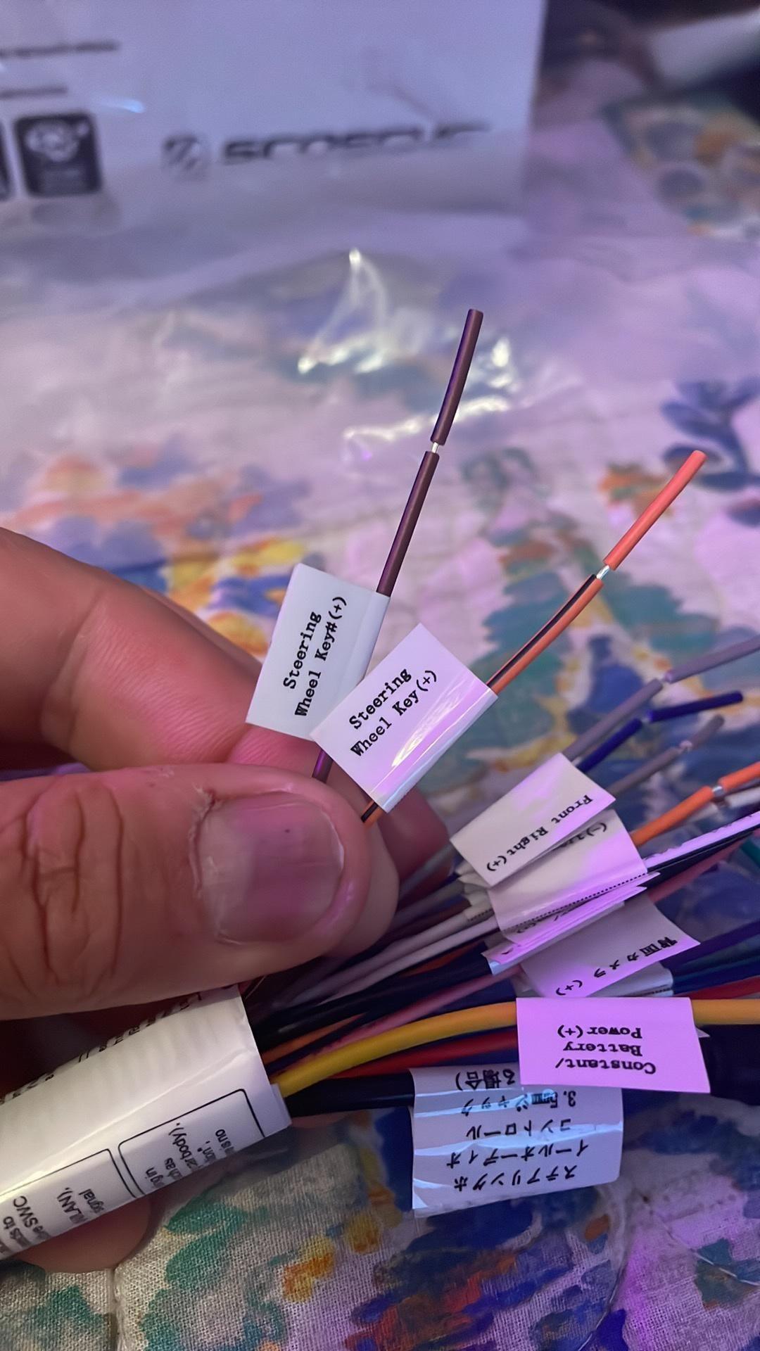

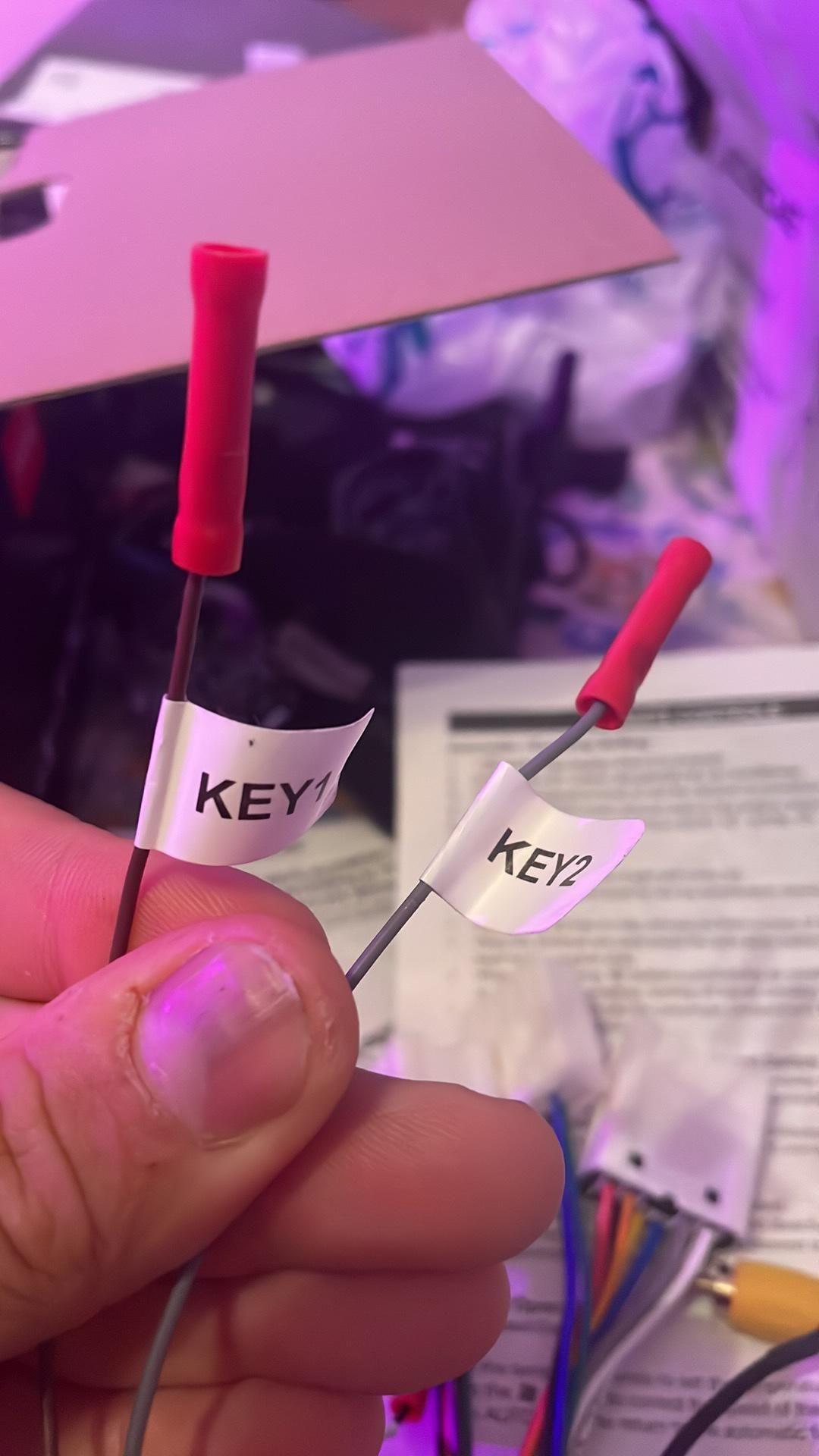

Also, I noticed the Scosche LPII15 has two wheel key wires for control. I purchased an additional wireless controller "an ATOTO wireless one, ATOTO AC-44F8" that's looking for a connection to one of the keys and accessory ignition.
Would it be possible to use both radio controls connected where the Scosche is connected to both keys and 3.5 and the ATOTO is connected to one key, ground and accessory ignition?

Wire layout:
ATOTO AC-44F8 wiring diagram:
ATOTO Wiring:
Scosche wiring
