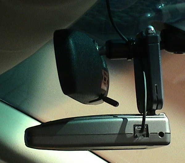

I invested in the Escort system and decided to install myself. I paid $340 for the blue light version of the 8500 X50, $300 for the ZR3, and another $20 for a special rearview mirror mounting bracket designed for the 8500 and 350Z from a guy on "my350z" forum.

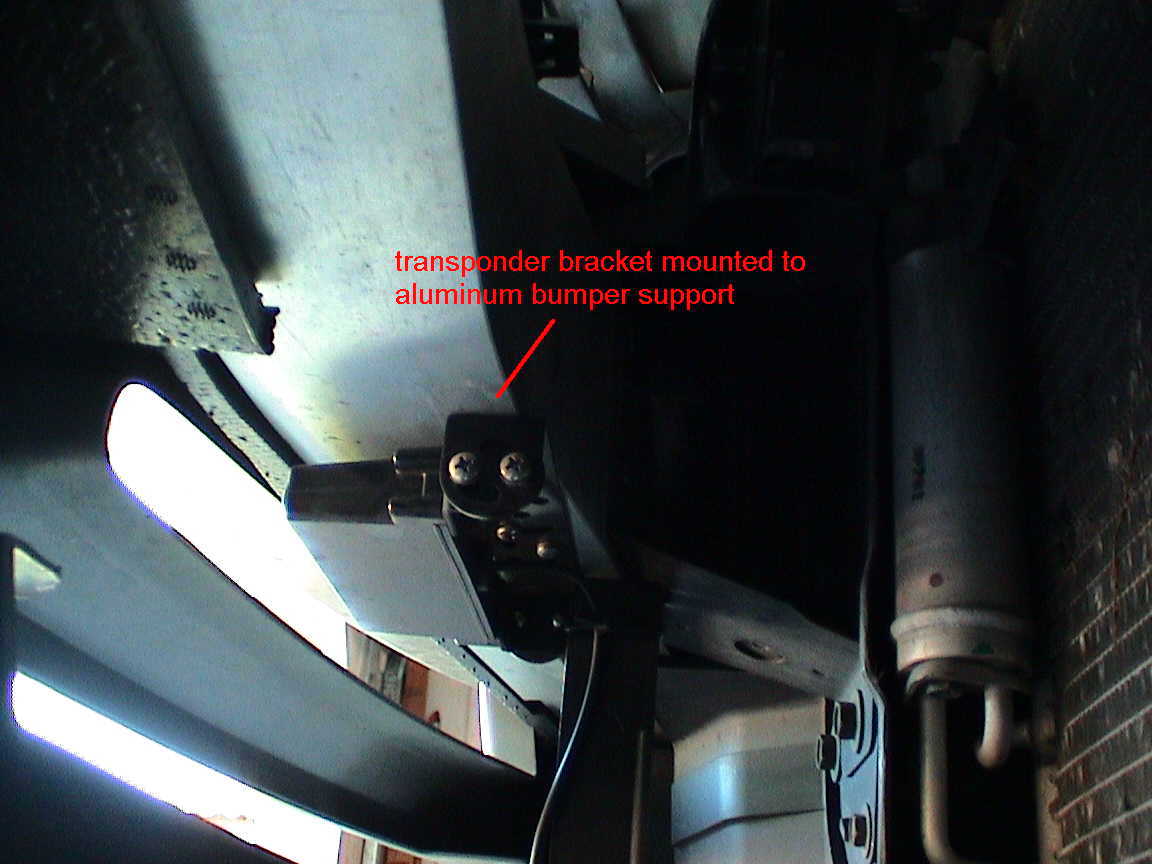

I had to mount two ZR3 transponders in the front, one ZR3 transponder to the rear license plate, run wiring to the ZR3 control module which I located near the radio behind the center console, and mount the 8500 with hidden wiring to the ZR3 control module. I discretely mounted the remote mute on the upper side of the center console [author's note: this mute button has since been relocated to the inside of the double din dash pocket under the aftermarket radio when I did my aftermarket audio conversion; there's another review on this; you can do a search if interested].
It took me 6 hours start to finish, by myself and taking my time. I hardwired the power for the control module to the driver side kick panel fuse box using the "easy V1 hardwiring" method from "Copbait". Most of my time was spent on planning, prep, and making sure everything was level, lined up, and that the transponders had a "clear view" of the road ahead. I'm attaching two pics of the front transponders.
After several months in use, I can safely say that the radar detector gives very ample warning in Ka band. The K band can be annoying because of false alarms, but there are occasional real warnings. The X band I simply turned off due to false warnings and that no one uses it in my area. The laser shifter has saved me at least twice, and without it I would have been nailed, detector or not. [author's update: I now only use Ka band and laser; I keep X, K, and POP in the off position and have never had any problems in my area.]
Attached Thumbnails Escort ZR3 and 8500 X50 Install & Review.-z8500.jpg   Escort ZR3 and 8500 X50 Install & Review.-zfront.jpg   Escort ZR3 and 8500 X50 Install & Review.-zmount.jpg   Escort ZR3 and 8500 X50 Install & Review.-zrear.jpg

Can you post a pic of the rear transponder? I don't see much laser use here in Seattle, but the ZR3 is pretty cheap on Ebay that it might be worth it if I go on a road trip where I've been hit by laser a few times (luckily I wasn't speeding at the time).
Done. See first post.
