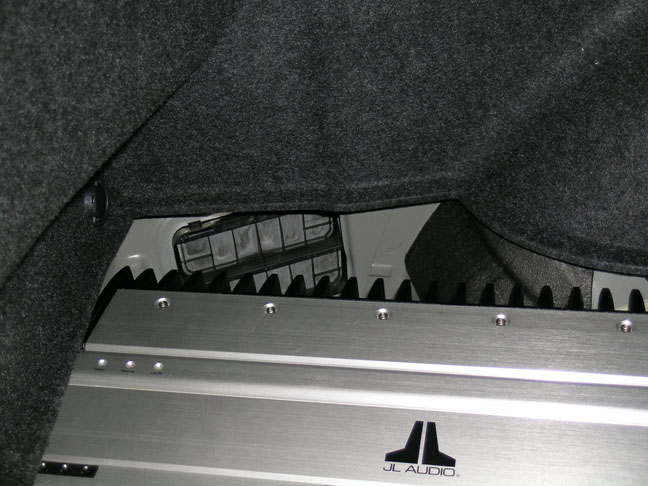

The only thing I would worry about is heat buildup from being in a confined space like that

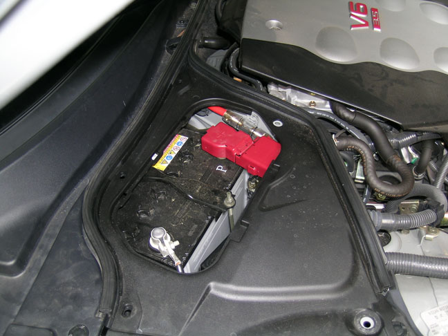

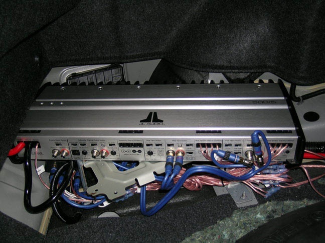

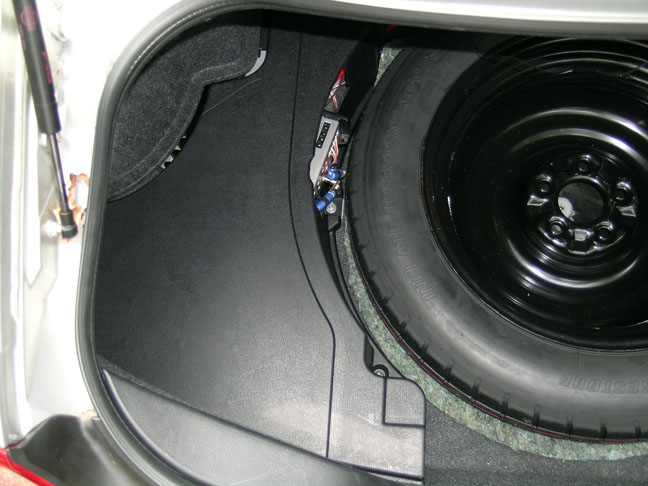

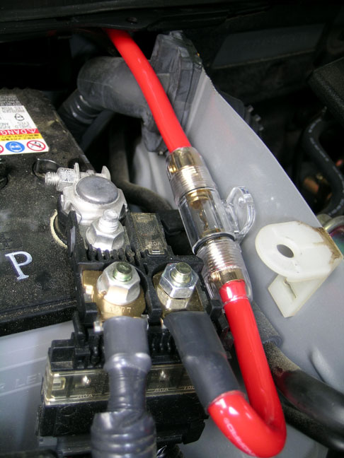

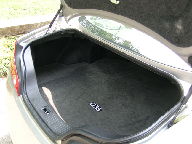

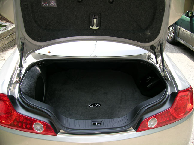

As promised, pictures (including the battery connections because I'm proud of how that turned out too):

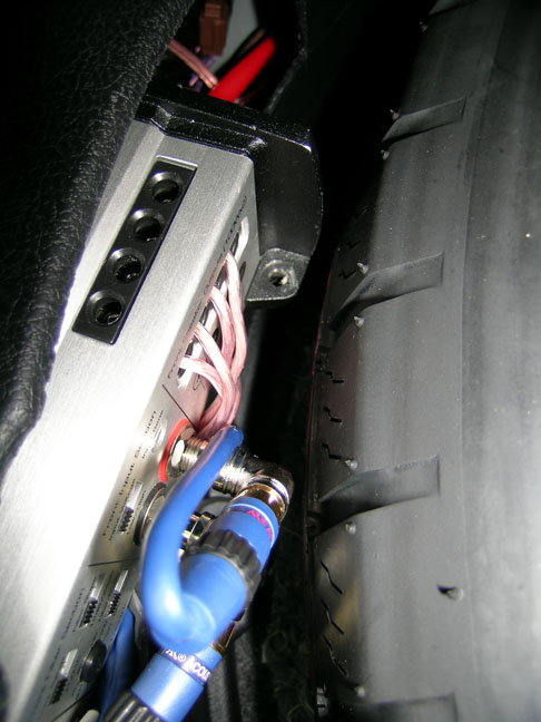

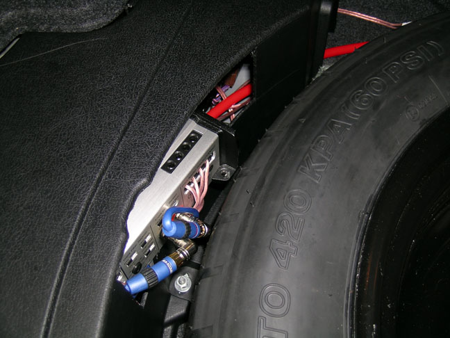

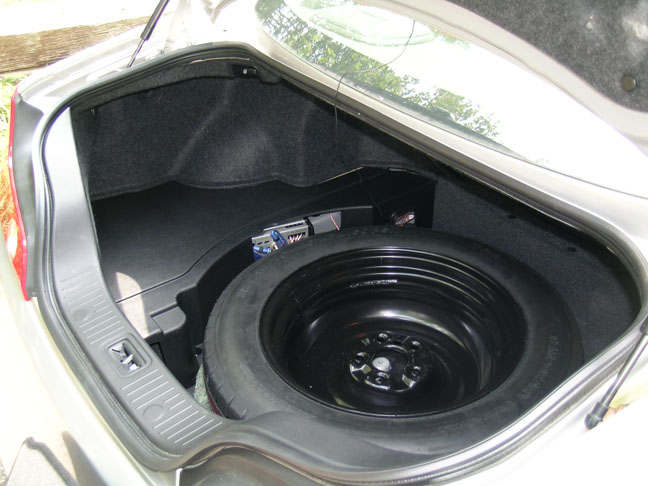

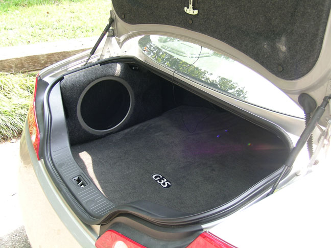

I had to use 90 deg. RCA adapters to get the plugs to fit. It's a little hard to tell but I took a picture of the spare and the RCAs and you can see a small space between them. It barely fit, but it fits!

Hey, amthar, is the amp bolted down? I can't tell for sure...
Old Sep 25, 2005 | 06:16 PM
amthar's Avatar
Posts: 1,464
From: Raleigh, NC
No. When I finished cutting the plastic flooring (both the small window and random other lips and pieces around the edges and underside) I placed the amp on top of the Bose bracket, put the plastic flooring back on it and screwed the flooring back down to the trunk. I went out and really put the traction control to the test, flew around corners, broke hard, etc, etc, to see how much I had to secure the amp. To my surprise the flooring pretty much held it in place as it's such a snug fit. To add some additional stability I put strips of industrial strength velcro on the top of the bracket and the bottom of the amp.
It certainly isn't moving.

r u worried about ventilation issues.? I heard class d amps really don't really produce a lot of heat but they still do..

Yes and no. I'm considering using some fans and duct work to exhaust air out the fender vent, but I'll worry about then when I determine exactly how hot (if at all) this thing is getting.

Try buying one of those $20 wireless thermometers and slap it in that compartment to test it out and see if you have to do the extra work to ventilate it.
