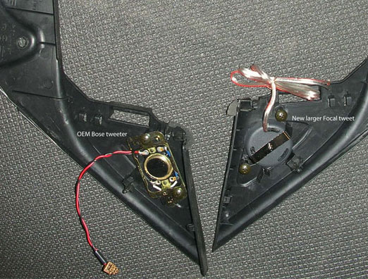

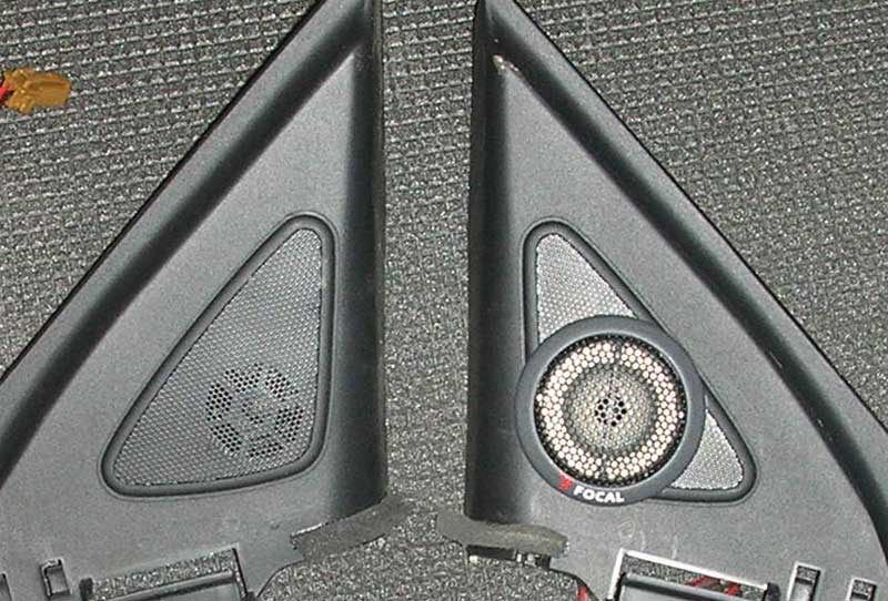

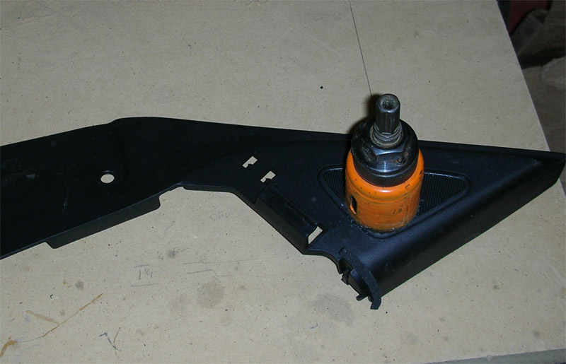

I mounted my Focals in the OEM location.
Took a little customization but worked out great.
Attached Thumbnails TWEETER MOUNTING: Stock position or do you go elsewhere on door?-tweet1.jpg   TWEETER MOUNTING: Stock position or do you go elsewhere on door?-tweet2.jpg   TWEETER MOUNTING: Stock position or do you go elsewhere on door?-tweet3.jpg
