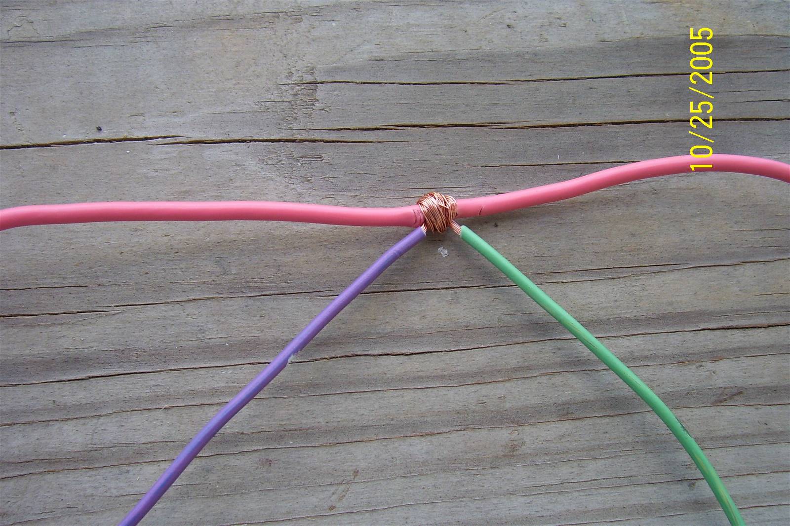

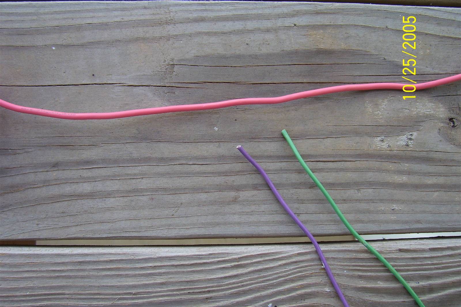

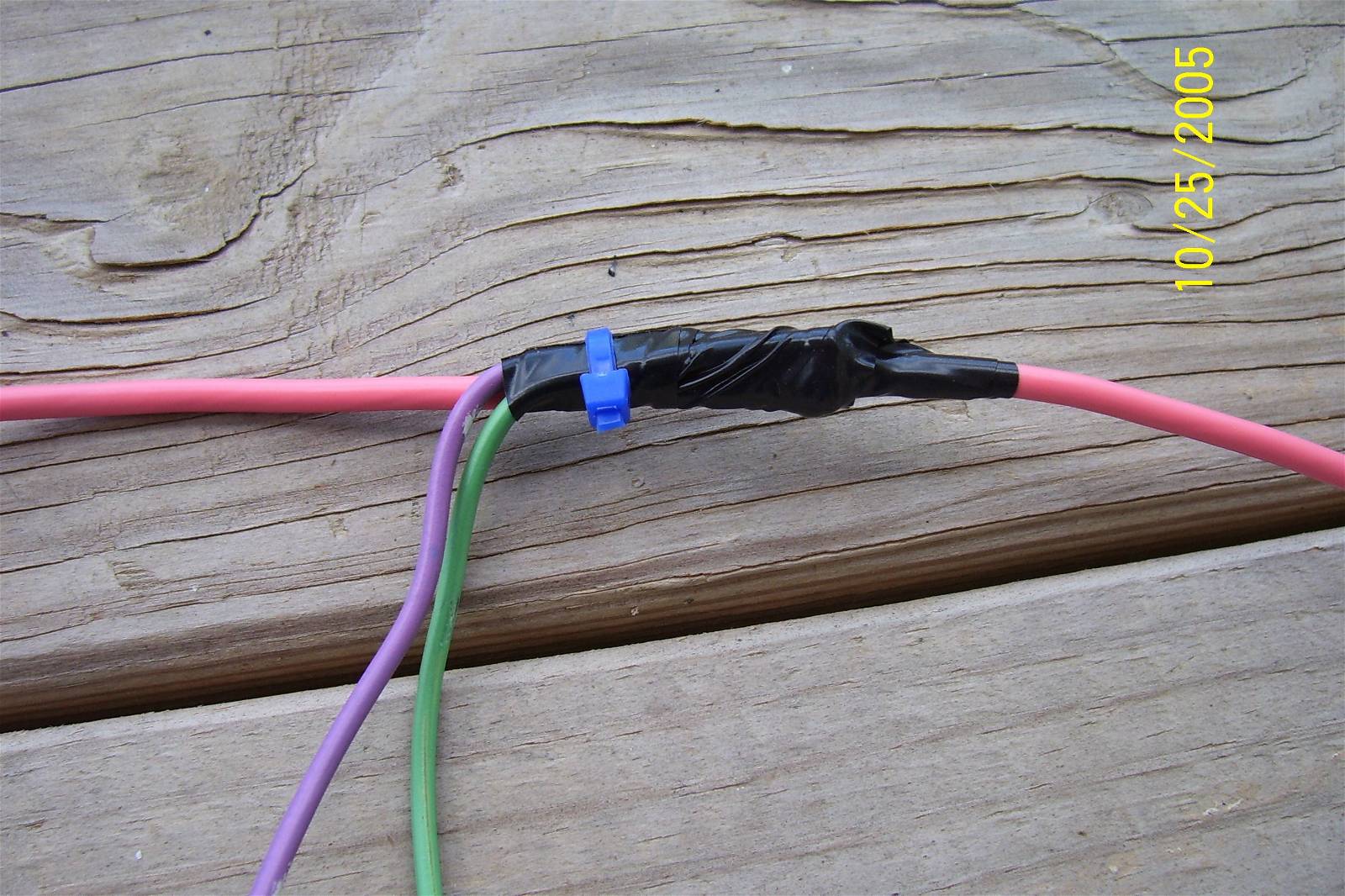

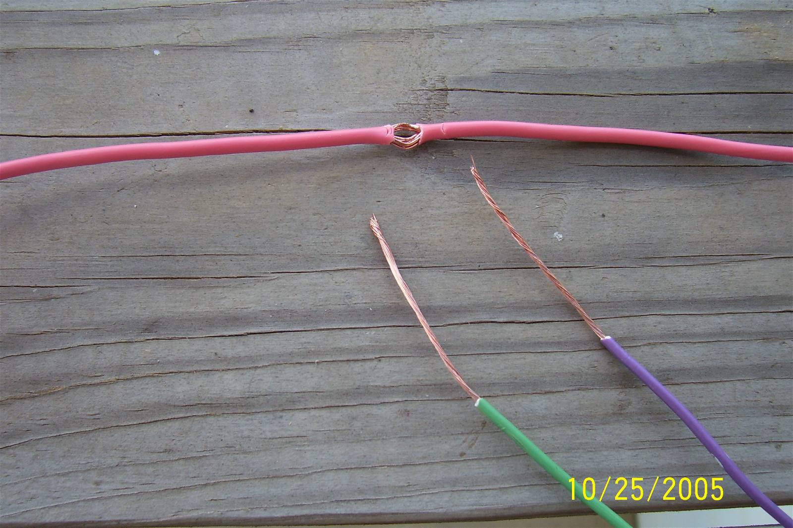

Maybe this will help those needing to tap the ignition wire, but aren't sure how. Pretend the pink wire in the pic is the igntion wire and the other 2 are anything your needing to get power to. Also make sure any power connection you add is properly fused. Hope this helps *Last 2 pics are backwards*
Nice suggestion. If you only need to power 1 thing though, it's easier to use a wire tap and add an inline fuse.

From: Moore, OK
Thats true, but you have to consider who is doing this and what experience they have. If someone were to use an 20-22ga wire tap on an ignition wire, then its very possible the wire will be cut in half. And also if they're not correctly used, can eventually fail.
