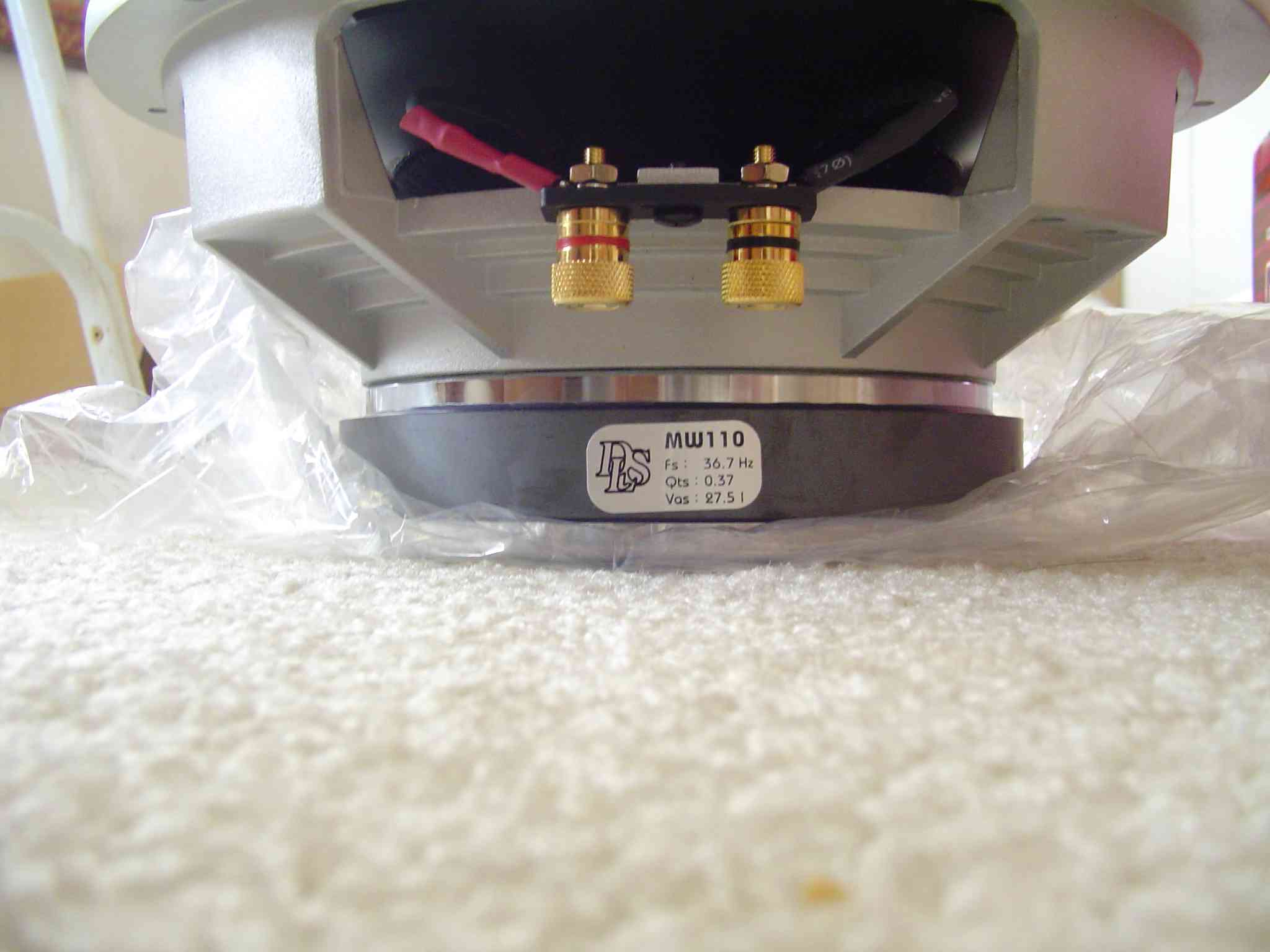

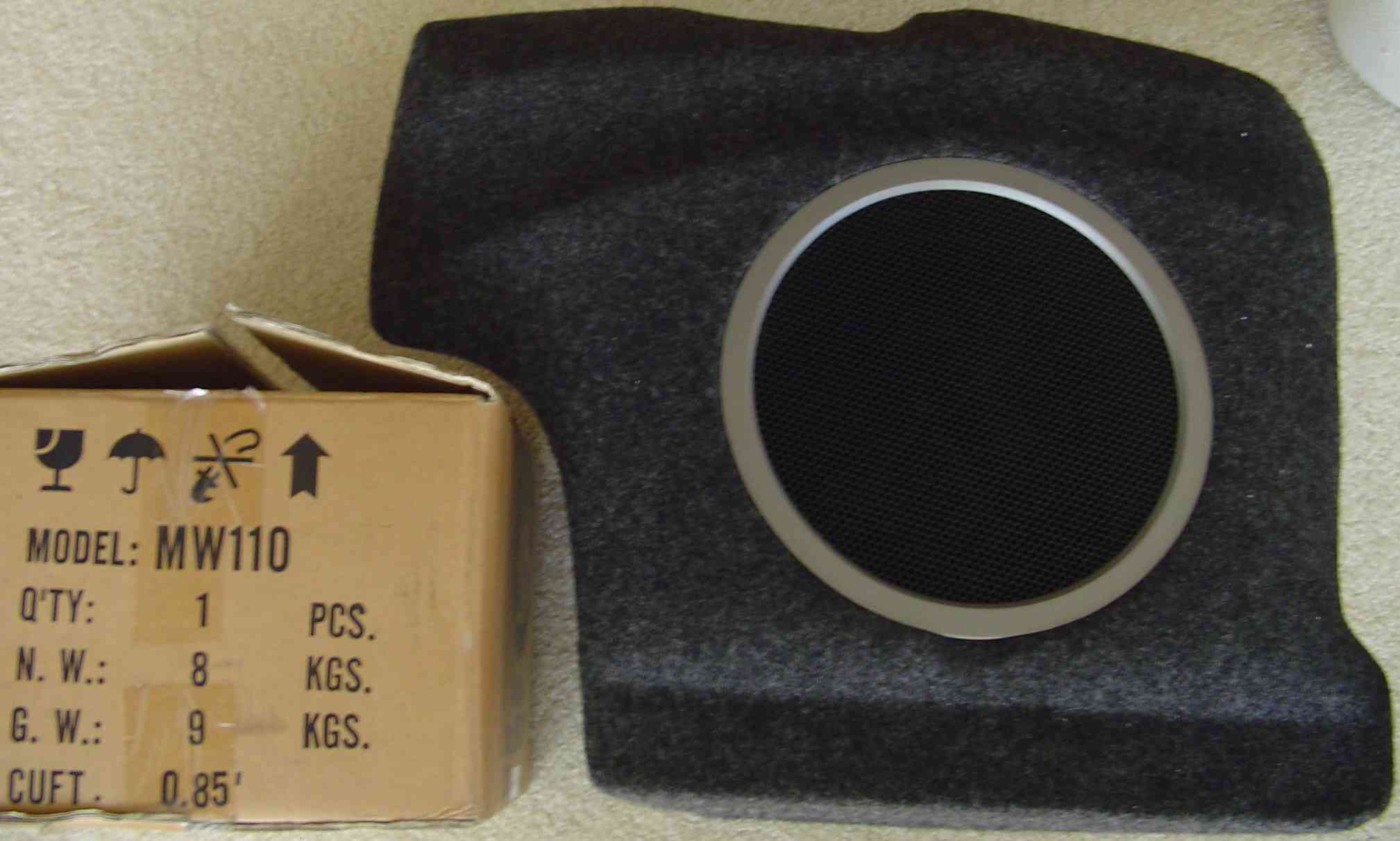

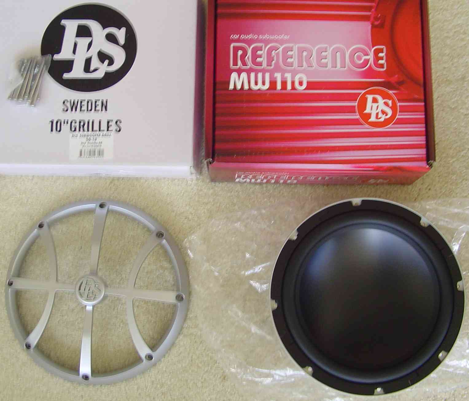

i got a 4080 box, i got a subwoofer (DLS MW110), i got a paper guide with the sub... now i got a question!

here's some specs on the MW110
10", 4 ohm, 350W nominal (max 550)
X-max: .35"
Fs: 36.7 Hz
Vas: .97 cubic feet
the 4080 10" box has .85 cubic feet internal air space
Attached Thumbnails 4080 box and Acoustic Wool-4080.jpg   4080 box and Acoustic Wool-mw110.jpg

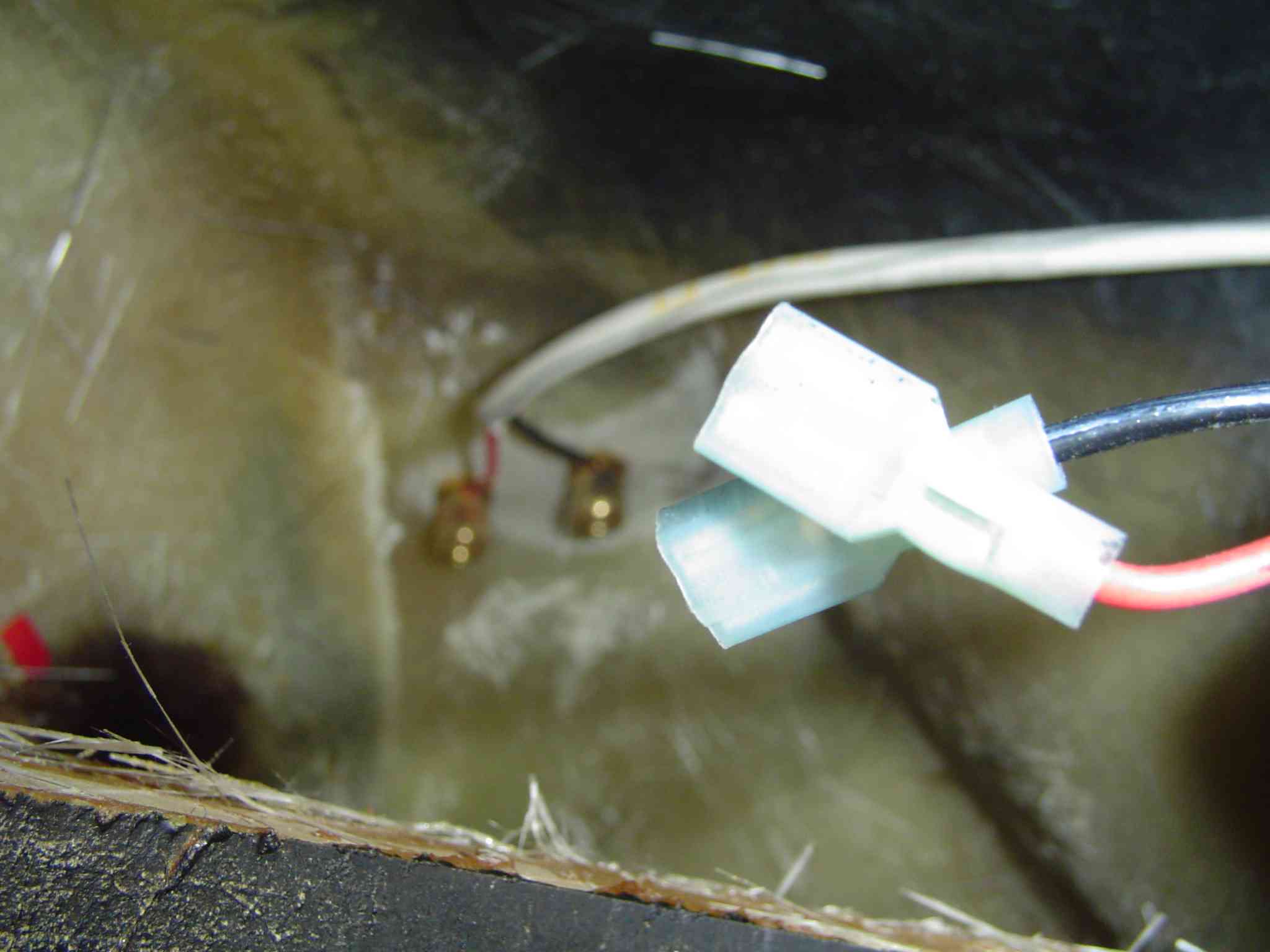

yeah, about the paper guides, i'm trying to figure out just what exactly is recommendation versus mandatory... another one of these is
"For wiring use high class speaker wires, min AWG13."
peeking inside the 4080, i see that Monster Standard 16/2 UL CL3-rated speaker cables (S16-2R CL) have been conveniently provided & set up for connection... i'm thinking that i should replace these with 13AWG or 12AWG twisted-pairs (for peace of mind if for nothing else).
i'll try to remember the warning about speaker break-in when i 1st fire her up-- don't wanna be raising bloody hell premature-like!
Attached Thumbnails 4080 box and Acoustic Wool-4080in.jpg   4080 box and Acoustic Wool-mw110connx.jpg
