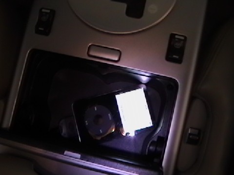

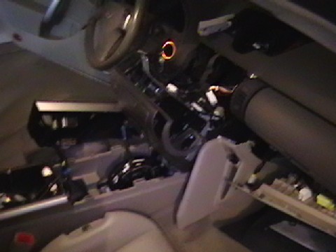

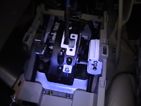

So awhile back i asked for info on installing the USA SPEC PA11-NAS and de/re-assembling the dash. I didnt get a ton of info or feedback so wanted to post a little bit of info on the process.
It was a chore, about 1.5 hours to complete. As u can see in first pic the whole dash(besides airbags and steering wheel) has to be disassembled-JUST to get the radio out!
Taking apart the dash in my $40K+(new) car and re-assembling it didn't thrill me; but it turned out fine. Only due to a website that gave GREAT step-by-step photo instructions, check it out if needed: http://g35ipod.com/installHW.php?skin=1
In regards to the USA SPEC PA11-NIS it works great...
I wanted mine to be a clean install and totally stealth, as it is. When in use there is NO need to see the ipod as it displays nothing important and you can't control songs from it. Controls are all done through the radio/steer wheel controls.
In the bottom rear corner of the cup holder i drilled a small hole(less then 1/2") to get wire connection into cup holder. This way I can remove the wire if i'm going to dealer or something, you cant see the hole-its stealth. Yes it takes up the cup holder when ipod in there, BUT i don't drink anything in my luxury sports car. -besides water bottles that fit in the door.
Minor PA11-NIS complaints:
1)its slow to change the track in middle of a song(like 2-3 second delay)
3)no text of song playing on radio or ipod screen(that i have seen)
3)radio display only goes to 99 songs so if you are playing song #144 on you ipod it says #43 on radio. -Dumb stuff, but may be worth mentioning.
check out the pics, sorry they suck, but my digital camera was dead so used the video camera.
I have an '04 w/ nav, bose, and NO sat service but a sat button.
PM me or post here if you have any dash or USA SPEC PA11-NIS questions, if i have an answer i will try to help you.
-Matt (artofdesign)

Well, check the forums again.. I posted a PA11-NIS install thread HERE a few weeks ago and recently a radio removal DIY HERE
Congrats on the install though.
When the unit is in DIRECT mode you can use the IPOD screen as you would normally in addition to the use of the car controls... so you might want to consider unstealthing it. The unit ships with the Dip switch in PLAYLIST mode, which renders the ipod display and controls useless (which is probably what yours is in right now)
I have read your posts, they were helpful yes, but you MT06 is much different then my 04AT.
I'll check out direct mode(yes, i read about it in manual but i have not tired it yet.). So with that direct mode i could choose ANY playlist?-not just a "NISSAN1" playlist?
Regardless, I'm the type whom perfers the stealth look: no billboard to thieves that i have a $400 ipod in there. And the untouched look of the beautiful interior look is what i enjoy.

Just installed this in my 05 coupe w/ bose - works great! 2 quick tips -
1.) If you want to see the info on and retain control on the ipod as well as with the steering wheel/radio controls, set dip switch 2 to off.
2.) If you have an 05 or 06 follow the directions in the following thread, you don't need to remove the glove box, driver side panels etc. I wasted an hour following the directions for the 04, then I found this thread and it was a snap!
