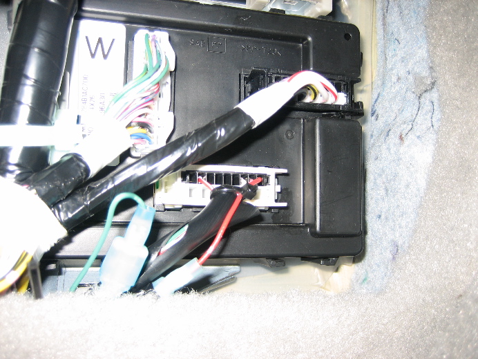

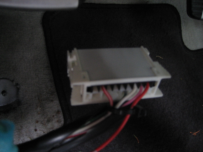

My harness as 5 wires. A pink, white, green, red, and red-white.

And here are some crappy pictures. I guess I will try the red & white wire next. I just hate to keep hacking into the harness.

What I have done.
I wait 30 seconds after arming, Infiniti LED starts blinking. I tap shock sensor, its LED lights but no alarm. If I open trunk (actually I pull the emergency open handle, while the trunk is open but locked) the alarm does go off. So assuming I did tap into the right wire, its signal does still go through the hook up. Since I used connectors I will try forcing the trunk alarm with the wires split. If the alarm still works I have the wrong wire, or if other trunk features dont work same thing. So it appears that that harness is diffrent between the 03, 05, 06 (or intellikey?). Was your 05 the same wiring as mine (five wire)? Thanks.

Still cant get it to work. With the solid Red wire I used disconnected the trunk alarm still goes off. so I dont know what that wire controls. The dash trunk switch still works, but the trunk light does not seem to be working with the wire disconnected or tapped into the sensor. I will have to wait until I get some more connectors before I try cutting the white/red wire.

try this
strip a little bit of the insulator of teh red white wire off
then take a wire that is connected to ground
after the alram has armed take teh wire that you connected to ground and touch it to the bare spot in the red white wire. if the alarm goes off when you do that you have the right wire
or take your dmm connect the black end to ground stick the red end into the red white wire and then pull the emergeny release. if the wire goes to ground when yo do that its the right wire.
if anyone has an 06 service manual could you please send it to me so i can find the correct wire quicker and easier
thanks

So I used the red & white wire just like it said in the directions. And it worked. So basically I read this thread a few days early. I dont know on the 05 & 06 listed, but on my 05 G35x (early production I have been told) the standard hook up works just fine. But thanks for the help. All the harnesses look a little diffrent.
