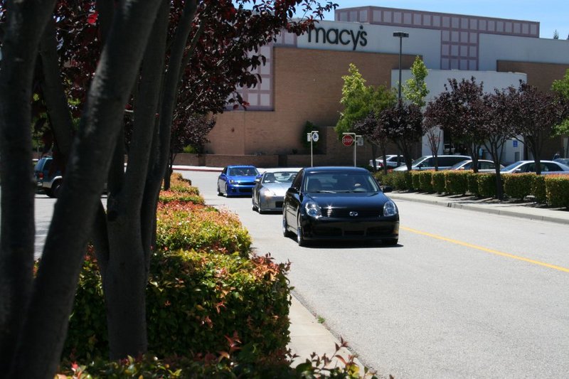

Any pictures of this done on a Black G35? I'm worried it would look too Black!

cool I may actually do this now with that product
didn't want mine to get all chipped up and continually have to re do it
also considered having it powdercoated black for the same reasons.
car done on black for whoever was asking....
Attached Thumbnails DIY blacked-out grille w/ pics-g-black.jpg   DIY blacked-out grille w/ pics-g-black-2.jpg   DIY blacked-out grille w/ pics-g-black-3.jpg
