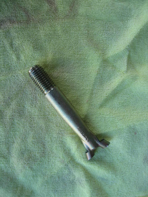

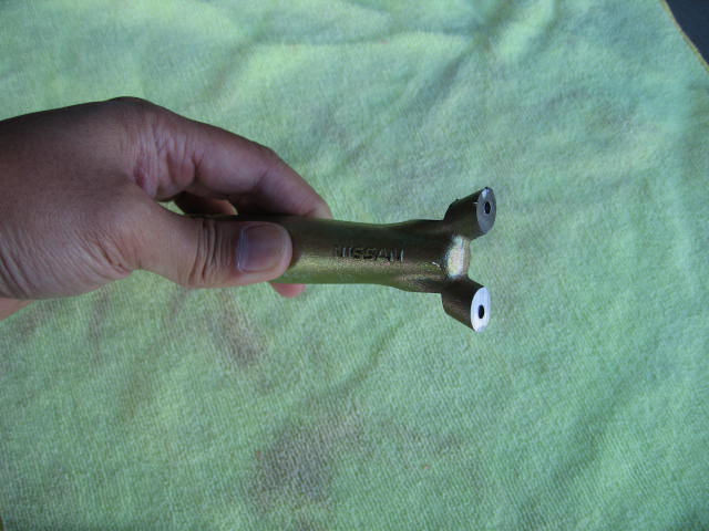

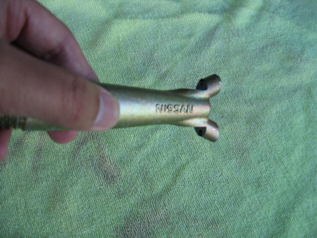

I did my own front license plate install today. It is actually quite simple and inexpensive. Total cost $17 for the license plate frame plus about $0.25 for two nuts and bolts. I know there are other options out there but this DIY allows you to decide how far the plate sits from the bumper...
-first I modified the tow hook with an angle grinder to remove most of the loop as you can see in the first 4 pictures. How much you grind down the tow hook determines how close it comes to the bumper.
-then drilled 2 holes in an old license plate and used two small nuts & bolts to attach it to the modified tow hook. The old license plate serves as a base plate to attach the new front license plate over it. (Note the heads of the nuts are visible in the 5th picture)
Attached Thumbnails DIY front license plate (no bumper drilling) with PICS-img_2937.jpg   DIY front license plate (no bumper drilling) with PICS-img_2938.jpg   DIY front license plate (no bumper drilling) with PICS-img_2939.jpg   DIY front license plate (no bumper drilling) with PICS-img_2940.jpg   DIY front license plate (no bumper drilling) with PICS-img_2941-edited.jpg

-then I attached my front license plate over the base plate using the license plate frame
-and here is the final product! You can see there is a small space between the plate and the bumper and it fits quite nicely. (Please excuse the dirty bumper. It's been a little cold here lately so I haven't had a chance to wash off all the bugs.)
Attached Thumbnails DIY front license plate (no bumper drilling) with PICS-img_2944-edited.jpg   DIY front license plate (no bumper drilling) with PICS-img_2945-edited.jpg   DIY front license plate (no bumper drilling) with PICS-img_2948.jpg   DIY front license plate (no bumper drilling) with PICS-img_2947.jpg

The factory bracket requires holes to be drilled. Here in CA we can actually get fined for not having a front plate on. Where I work we've had coworkers come back to their cars with tickets on their car while parked in our own business lot. They not only had to pay a fine but had to show a cop that it was fixed. Yet others don't have that problem in other areas. I do not plan on keeping the car for more than 3-4 years. So the main reason I did it was for RESALE APPEAL. Many G35 enthusiasts/potential buyers in CA will not want a front plate on their car and have never had a problem with tickets for not having a front plate. When it comes time to sell my G I can take off the front plate and the new owner can decide if they want to keep it that way or put it back on.

Not a bad idea, but I rather not detroy the only thing that allows your car to be towed.
Old Dec 16, 2005 | 12:07 AM
MechEE's Avatar
Joined: Dec 2005
Posts: 1,214
From: San Francisco
My thoughts too, hence why I asked about the price of a new tow hook.

I have been looking for a way to do add my front plate for the longest without drilling holes but i can't understand how you have it connected to the bumper without holes
Old Dec 16, 2005 | 12:44 PM
twantrd's Avatar
Posts: 120
Well done! I've been using tip ties and tieing it to one of the bumper vents. But this looks a lot better, the only problem is that I don't have a good enough grinder to do this.
fabulustt7,
There are no holes in the bumper as he uses the tow hook mount. The tow hook mount is located in the middle of the bumper (behind that little plastic square). So, pretty much he makes 2 drilling mounts on the tow hook and uses that to mount a license plate (as a base) and his real license plate over it.
