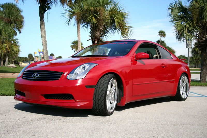

Finally, the finished product.
I have had the A-arms on the car for about 5 weeks now. They have been to the alignment shop and the alignment guy had no problem adjusting them to get the alignment within spec. They have over 2500 miles on them now and I have had no issues with them. They don't make any noise, like some do. They are easy to install and they are a well built product. They do weigh more than stock, but all aftermarket A-arms will likely weigh more than the stock aluminum units. For those the want to adjust caster or that have extreme drops, these are the only choice on the market right now.
I didn't install the shims between the hub and the steering knuckle. It will take more effort to install those shims, but if you need the extra positive camber, the shims will provide it to you.
Edit: I found my alignment specs. We eyeballed the alignment after installing the SPC front A-arms and SPC rear camber arms and toe bolts.
Before alignment:
Camber: LF -0.3 RF -0.4 LR -1.8 RR -1.7
Toe: LF -0.09 RF -0.07 LR -0.47 RR +0.55
After alignment:
Camber: LF -0.4 RF -0.4 LR -1.3 RR -1.3
Toe: LF +0.05 RF +0.05 LR +0.10 RR +0.09
