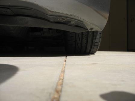

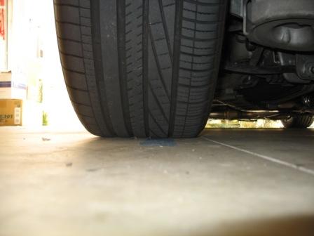

As requested, here are a couple of pictures reflecting my tire contact with the ground (albeit an unoccupied car not moving). Those tires have ~ 12K miles on them.
Attached Thumbnails Do I need a camber kit?-tire-front.jpg   Do I need a camber kit?-tire-rear.jpg
