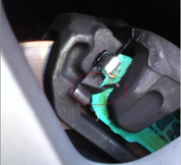

I just had some Project Mu NS pads installed by a local shop but there's a clip that does not seem to be clipped in on the front pads. I have attached a picture to show the clip.
Is it necessary and should I bring it back to have them correct it?

it doesnt HAVE to be in, it wont hurt anything if its out, same thing happened on my friends car when we painted his calipers. Might want to take it back to them just so you know they did the job the right way.

I just kinda bent the clip a little so it fit and straightened it back once the clip was in.

The service manual says this is the "Pad return spring". I would think Infiniti put this there for a reason, even though it doesn't seem to do much...

That tab goes inside the little loop on the brake pad (the brake pad wear indicator) so just stick it in there with your fingers. It won't hurt anything if it's not in there though.
