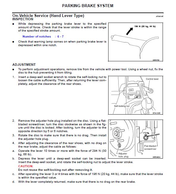

The cable can be adjusted:
Also, you do realize that the e-brake doesn't engage the rear caliper pads, right? It uses separate brake shoes inside the rotor.

^^ Great find!! Should be a quick and easy fix just don't make it too tight.

It's not a find - I have the service manual and uploaded the pic...

thank you very much for that -- i honestly had no idea that the ebrake did not use the pads. i figured that was why i had to pull it up so high -- maybe I will do what dreamg35 said leave it in gear and pull the ebrake -
i will tighten the cable on thursday, i am installing my spacer on thursday anyway. thanks again for the post out of the service manual

what is the first picture of, it won't pull up, it only shows the infamous X

Same thing as the attachment.
