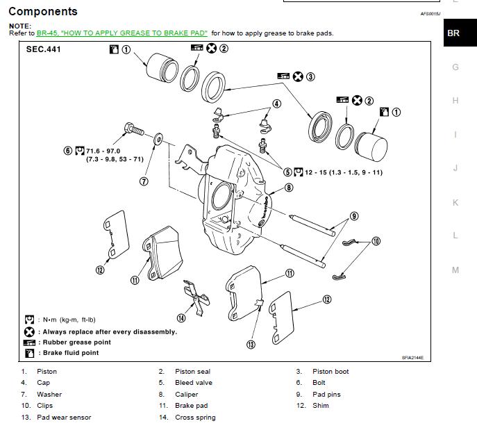

4) I believe the rear Brembo pads are symmetrical aside from the wear indicator. See attached from the FSM:
