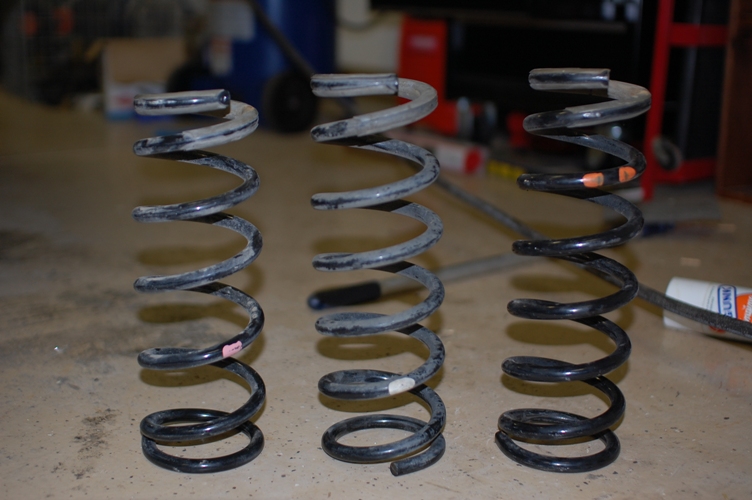

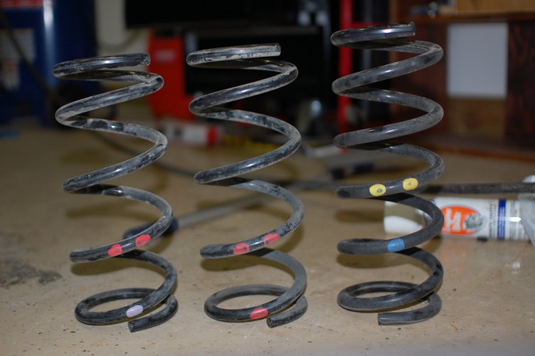

^^^Sorry I didn't see this before. This will show the slight differences in height.
Attached Thumbnails z springs front/ coupe springs rear--ID reference-rear_springs_350z_g35coupe_g35sedan-sport.jpg   z springs front/ coupe springs rear--ID reference-front_springs_350z_g35coupe_g35sedan-sport.jpg
