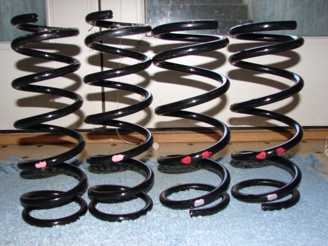

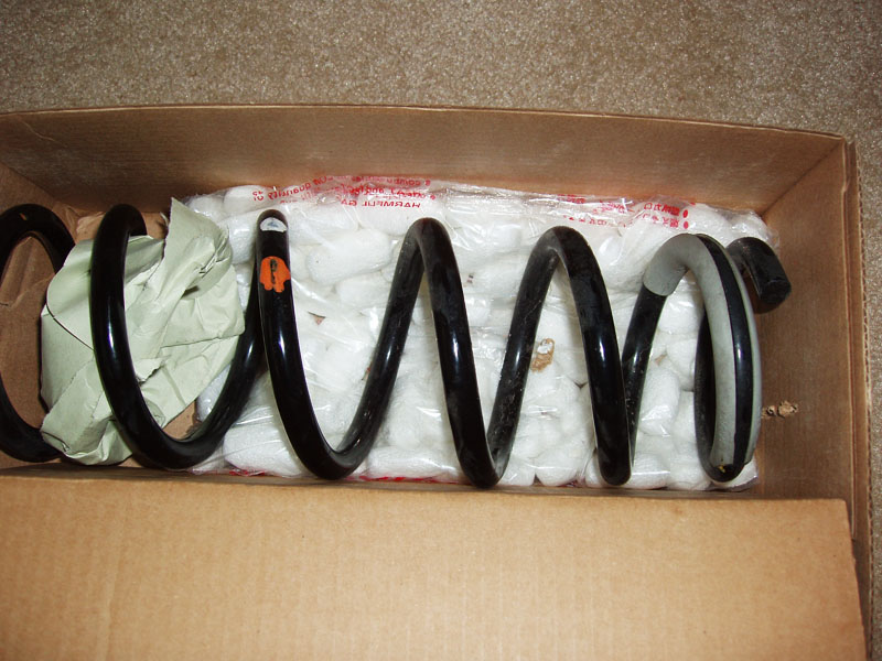

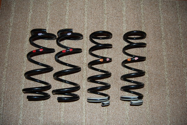

For 350Z springs--will drop a sedan 1" on all 4 corners.
Fronts are 314 spring rate and have 1 pink dot and 1 orange dot. Coils are tighter and most have the rubber sleeve on them.(2007-2008 models have 1 white and 1 orange dot) Tech farmer mentioned some z springs front may have only 1 pink dot z front are confusing
Rears(revised,2004.5+) are 427 spring rate and have 2 red dots and 1 purple dot.
(2007-2008 models have 2 red dots and 1 blue dot)
Rears(unrevised 2003,some 2004) are 342 spring rate and have 2 red dots and 1 white dot.(1 white dot)
Attached Thumbnails z springs front/ coupe springs rear--ID reference-2003zsprings.jpg   z springs front/ coupe springs rear--ID reference-zoemrevisedsprings003es8.jpg   z springs front/ coupe springs rear--ID reference-2008zfront.jpg   z springs front/ coupe springs rear--ID reference-zsprings.jpg

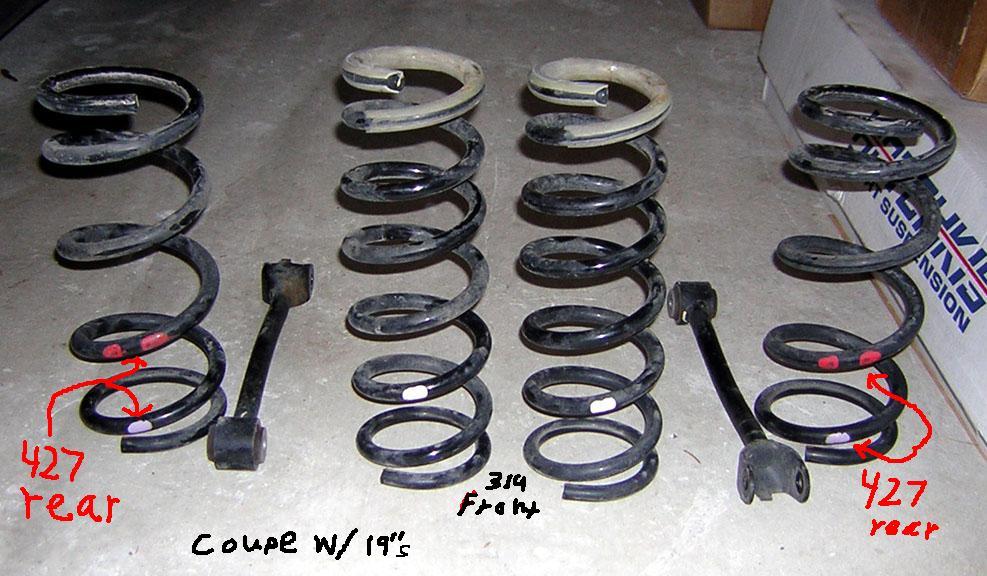

For coupe springs: Lowers a g sedan 1/2" on all 4 corners
Fronts: 314 spring rate with 1 white dot.(1 white dot)
Rears from a coupe with OEM 17s/18s: 342 spring rate with 3 red dots
Rears from a coupe with OEM 19s: 427 spring rate with 2 red dots and 1 purple dot
Attached Thumbnails z springs front/ coupe springs rear--ID reference-342rearcoupe3reds.jpg   z springs front/ coupe springs rear--ID reference-coupe314and427springs.jpg

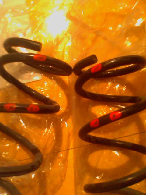

I just bought some "coupe springs" from the marketplace, but they are the exact same size as my oem g35x springs. Same size; same dots (2 yellow/front; 2 yellow,1 pink/rear.) Bought them from a guy with an x...
Do they look identical or did I get screwed?
