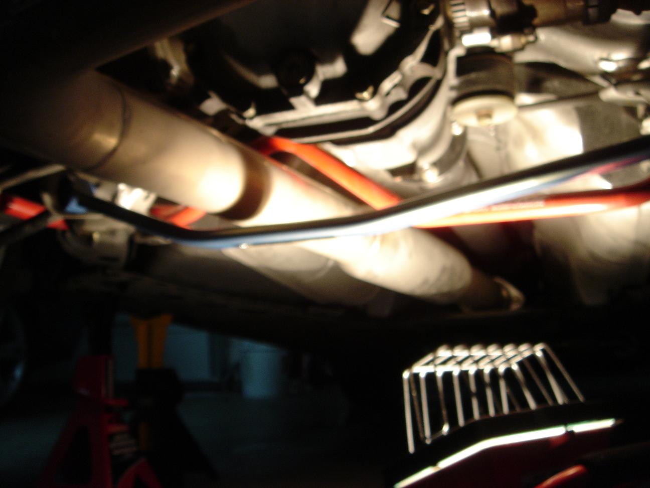

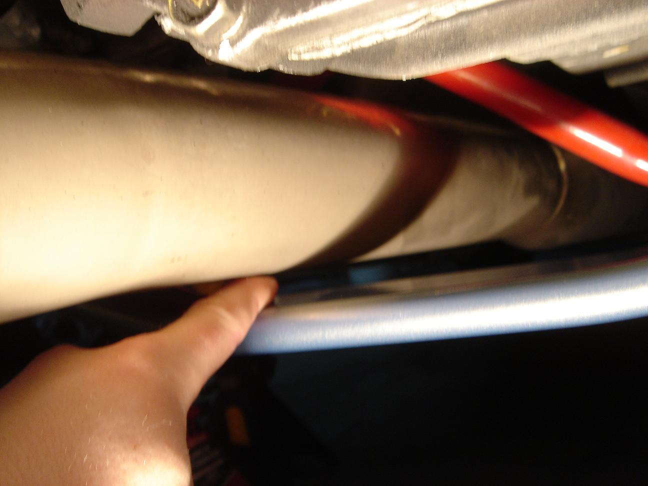

I thought the rear lateral arm brace would give me the biggest benefit in handling out of all the GTSpec lower chassis reinforcement products, but supposedly it doesn't fit any but true-dual exhausts. I did some more searching and some threads vaguely state that it fits some single-pipe exhausts sometime somewhere, but didn't say which ones or under what conditions. Judging by how high my Top Speed Pro N-1 exhaust is from my previous work on the car, it looked the same height as the true dual picture GTSpec vendors use to demonstrate the rear lateral arm brace. I decided to buy it along with the other tie braces due to my observations.
I installed the rear lower tie bar and the rear lateral arm brace tonight and the rear lateral arm brace fits like a glove on the Top Speed Pro N-1 exhaust. I would assume that this then is also true for the RSR and the Invidia single-pipe exhausts, because they all use the same blueprint for the exhaust, but just have different finishes on the materials. NOTE: I also have the Top Speed Y-pipe installed. Although I don't think it causes the exhaust to be held any higher than stock y-pipe (or any other y-pipe) with the Top Speed midpipe-down set-up, but who knows, I'm just letting people know what my set-up is to allow this brace fit.
Pics attached. (Sorry for some of the poor quality, I was just going for the general idea, not to win a gallery competition.

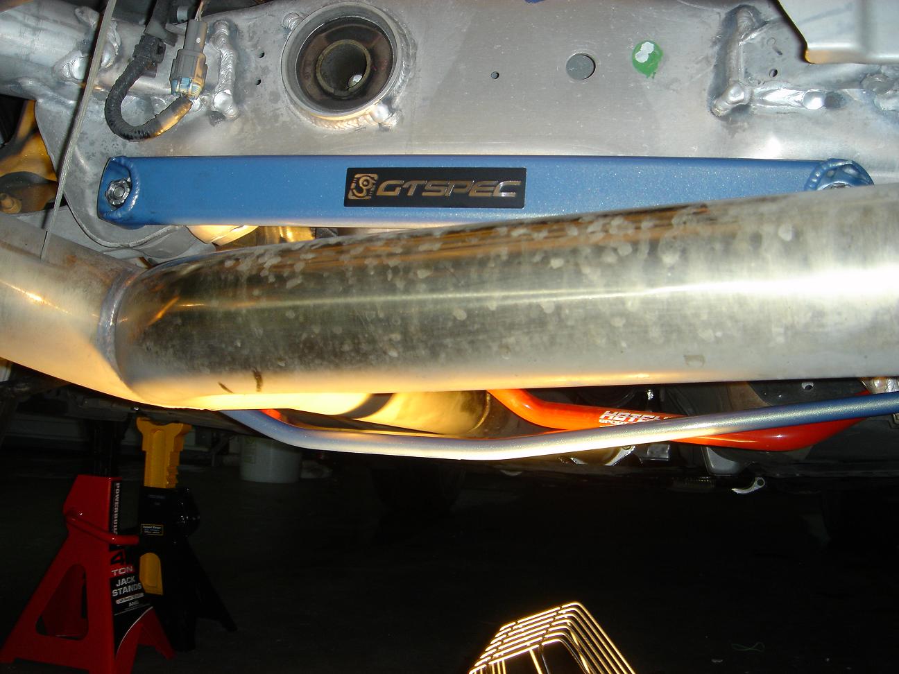

I can see how the rear lateral arm brace would help handling, but I am kind of debating what the point of the rear tie bar is. It basically bolts onto the rear suspension member, which is a huge rectangular piece that holds the whole rear suspension together. This thing is the fatty piece of metal that you see under the back of the car. Not sure if this little GTSpec tie bar is going to do much to help that huge hunk of metal do a better job. I almost laughed, the tie bar literally just screws on from one end to the other. The rear suspension member has an upwards curve versus the straight GTSpec bar, so it's literally off by about 1-3 inches from completely matching the rear suspension member's lateral support. I just thought it was pretty useless, but who knows. I'm hoping when I install the front lower tie bar that it would look like it's doing something a bit more sensible than the rear one.
)I can see how the rear lateral arm brace would help handling, but I am kind of debating what the point of the rear tie bar is. It basically bolts onto the rear suspension member, which is a huge rectangular piece that holds the whole rear suspension together. This thing is the fatty piece of metal that you see under the back of the car. Not sure if this little GTSpec tie bar is going to do much to help that huge hunk of metal do a better job. I almost laughed, the tie bar literally just screws on from one end to the other. The rear suspension member has an upwards curve versus the straight GTSpec bar, so it's literally off by about 1-3 inches from completely matching the rear suspension member's lateral support. I just thought it was pretty useless, but who knows. I'm hoping when I install the front lower tie bar that it would look like it's doing something a bit more sensible than the rear one.

That sucks man. on the coupe the rear lower tie bar (last pic) is very far from my exhaust. There is probably a good 1.5 inch distance. I was thinking of getting out a measuring tape and seeing what the dimensions are of all the GTSpec bars in terms of clearance so people can make an informed decision without having to take a gamble by seeing where their exhaust hangs.
