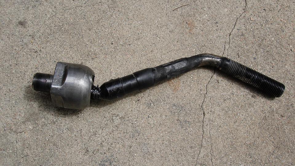

you know what. it would help if this rod was straight. hahahah well i'm glad i found the problem.

Whoa!
That'll do it.
A picture is worth a thousand words.
I'd take that sucker to a shop for an inspection ASAP.
Who knows what else is bent.
That kind of damage doesn't just happen.
Somebody curbed that bitch, or worse.

Well. I dont' think the car was ever in an accident. It seems like he ran over something that caused it to bend. Anyways car is in a body shop right now for the body work and also the paint. Glacier Frost Mica!!!
