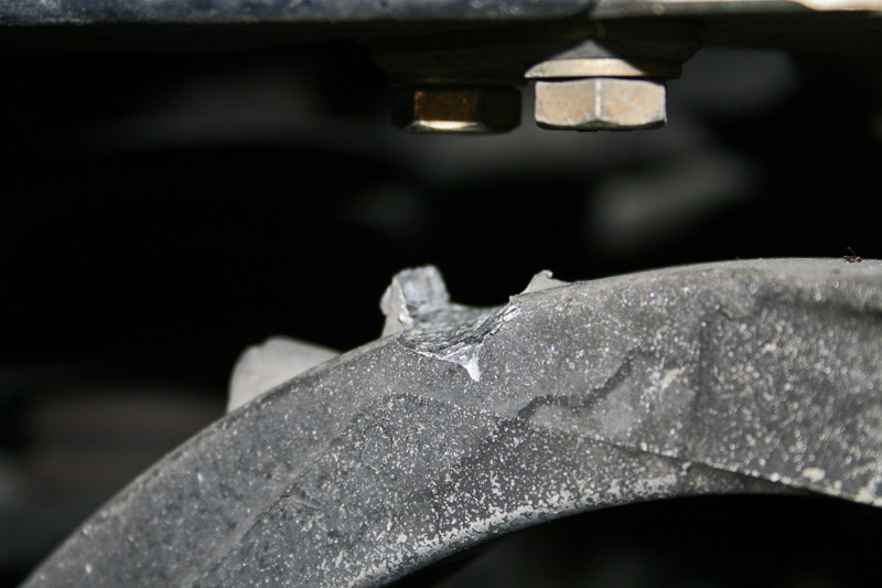

I'm having some clearance issues with my 350evo upper control arms. The adjustment nuts are contacting the spindle arms at full left or right steering lock when the suspension is very compressed. I'm about 1/4" higer than the lowest point on my HKS Hipermax RS coilovers. Front suspension also consists of Stillen sway bars with OEM end links. I've increased the stiffness of the coilovers to try and avoid any additional contact. Anyone else have similar issues?

u might be lower than me.
i've had almost no clearance issues with my setup and the only difference between us, aside from height, is the swaybars.
I don't think the swaybars have any affect.
Take a pic to see what's actually contacting and post up?
let's see what's going on there. it'll help.
-DRU

I'm running the 350 evo front a arms, bilstein pss9's, stillen sways, & adjustable endlinks. NO issues what so ever. I'm dropped to the point where I can't fit a finger between the tire & the fender. Jusat had alignment done & im in full spec of oem.

Here's a close-up pic.
Attached Thumbnails Clearance issues with 350evo upper control arms?-350evo-01.jpg
