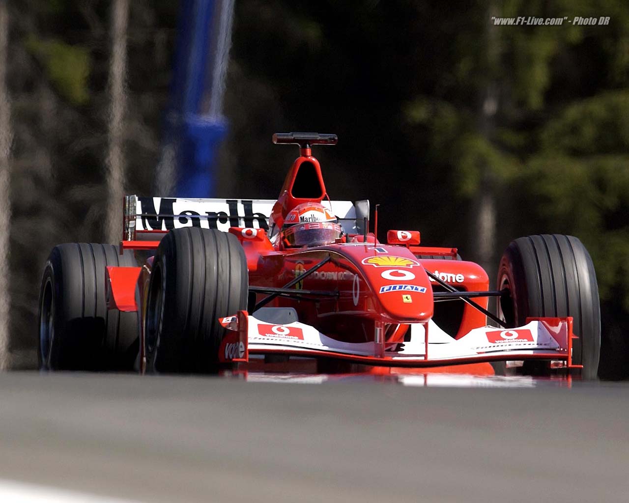

As best I can read the sheet you posted, you are little more negative camber than spec on all four corners:
LF 1.14 degree excess negative
RF 0.60 degree excess negative
LR 0.67 degree excess negative
RR 0.61 degree excess negative
If you drive aggressively and corner hard, just run it that way. You are going to wear out the outside edges of your tires first anyway, this way it won't be as bad.
If you drive conservatively you will see a little more tire wear but probably not enough to justify the cost of a camber kit plus installation (and another alignment!).
Look at the camber on the front of this thing -- and it has a lot stiffer chassis than yours! And yes, they are VERY concerned about tire wear<G>.
