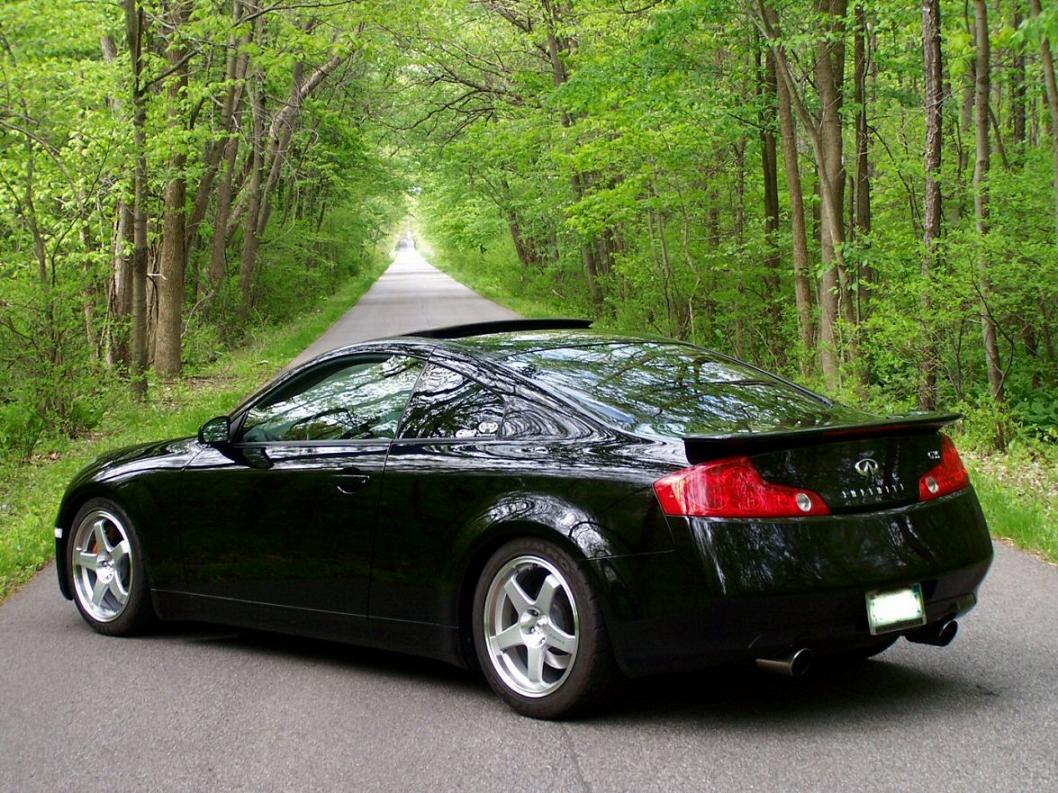

Yeah bad idea cutting springs. I ran the Eibach Pro Kit on my 03 6MT and had great results. Rode/handled great. Added the sways front and rear which made the car handle on rails. I ran 245/275 in 18" that has the same dimensions as the 19's you have listed and didn't have to mod the fenders. Pic of my old G dropped *sniff sniff*
